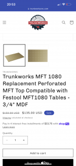

I see replacement Mft1080 tops are on sale for $135 at trunkworks.
They also sell a replacement mft top for the MW1000 and the MW1000 extension table for those interested.
