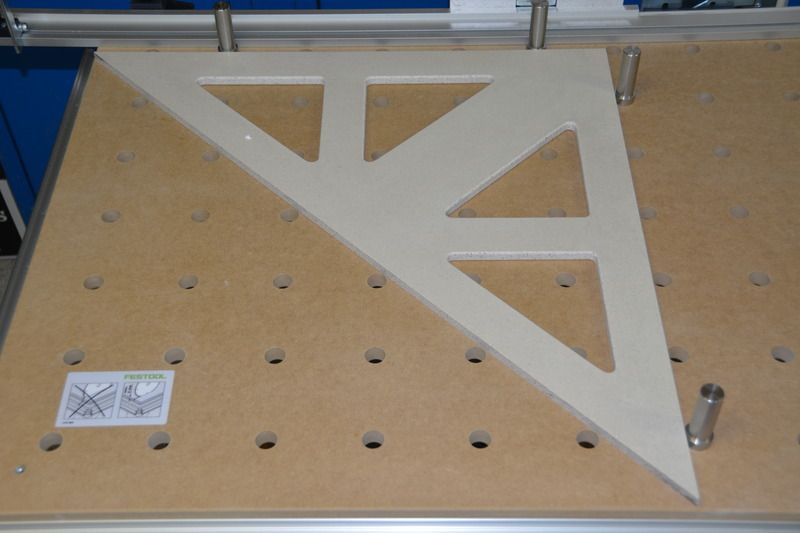

Late to the party, but: Festool MFS - has also other nice uses apart from being able to square a MFT/3.
