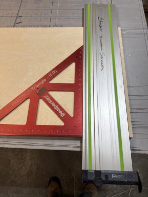

Has anyone attached one of the large Woodpeckers square to their guide rail?
I have the Festool version of the TSO square attachment and I find it’s not as accurate as I’d like. Idk why, just seems every time I use it, it’s off by as much as a 1/16 depending on the length of the cut.

Some of the other guys have more experience with this and will have more pointed observations to share, but in my experience, the square may be perfectly square but you may still have to set the rail. I've found that on my own (new) MFT setup, I have to check square at the hinge and then make sure that the rail support on the other side is also set correctly. Even just a smidge off will make the cut wonky. I'm suspecting this is what's happening in your case - the rail is set square but the other end isn't laid down as precisely.
How to do that better and rectify the situation? I don't make cuts like this much, and when I do, I mark and set both ends of the rail. But I'm sure others have dealt with just this issue.

Keep in mind the FS-WA/90 can be as accurate as it gets but if your rail is not - in the short section that interfaces with the square - then the whole assembly will not be accurate.
Did you test/check the accuracy of the rail square against the WP triangle?
Did you do a 5-cut test. It may be your WP square is the one not actually being square. Then there is the technique. Etc.
If not, do both.
All of this is why IMO people should start with the adjustable FS-WA /+ a precise square for calibration/ instead of the GRS 16 (FS-WA/90) fixed-angle square as the only one they have.
That way any imperfections in the rail used can be compensated for and one has a fallback option. Similar like with the Makita rail connectors.

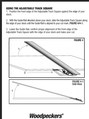

But I wonder if this is possible for you to try? I had to follow this page for how to lay it down (I didn't at first as I skipped the instructions). Once I did this, my problems went away; it's essentially having it against the workpiece at an angle in the air and laying it down:

The lifting of the track, while the square has the track on your mark, seems to be the key to square cuts when using a track square.
My guess is this works best with 4’ cuts or shorter.
That is pretty much the case with all rail squares. The reference face to cut length ratio gets too far out to be effective.
