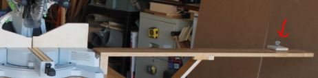

Neither vertical fence nor track. KISS.
4nthony said:
I came across a Wood Whisperer video where he switched to a no fence miter station and relied solely on the miter saw fence as the single material point of contact for square cuts.
If you set up moving block in the same plane as the saw fence and place flip stop on the other end, it will provide another point of contact. Indeed, no need for a continuous fence.

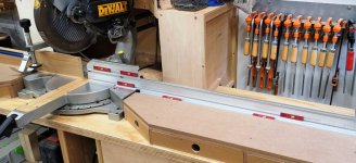

Well, I started this thread about 5 months ago, and I received my StealthStop kits about 2 weeks ago. I finally got around to doing something with them. Well one so far. I thought I would share what I had and where I'm at now with the Woodpeckers StealthStop installed.
I removed my old Kreg flip stop system that I have been using for a few years now. I like it well enough but the biggest issue was not being able to set a stop closer than 12 inches from the blade. I have used a spacer to let me reach into that 12 inch space when need be. Not that difficult but I want something different.
So I bought into the StealthStop last Fall and they were shipped out to me a couple weeks ago. I've been busy with other projects and printing parts for the LR32 Adapter Kits and also a number of fence caps for both the MFT/3 and the Woodpeckers SuperTrack used on their drill press table.
All the while I was thinking about how I might install the StealthStop on my miter station. I didn't want to redo the whole thing. I also thought am I going to get a new mitersaw anytime soon. I've had the DeWalt DW708 for a long time. It still works and cuts fine so I don't see me replacing it in the near future. So I decided to use the StealthStop with what I have which meant cutting the bottom track down to 36 inches. I really hesitated doing this thinking I will probably come up with a better way tomorrow but too late now. :-)
So I removed the Kreg fence and flip stops and figured out how I could mount the SS. I knew it would not be a conventional install. But then I don't believe anyone has posted an install here yet. The only one I've seen is [member=7266]jeffinsgf[/member] when he did his Deep Dive YT video in his shop.
I had to drill the fence to be able to mount the vertical track. The horizontal track I cut 12 inches off because the wing is only 36 inches long. That gives me 48 inches to the right of the blade. I took that 12 inch piece and placed it above the vertical track. That doubled the height for the first 12 inches to 4.5" (each track is 2.25" wide). I was able to secure this piece to the MS fence too using a pair of 1/4-20 HH bolts and nuts.
In the end I gained back 1/4" of crosscut capacity. Previously I had a piece of 3/4 x 4-1/4 stock screwed to the face of the fence. The Kreg flip stop track needs 3/4 material to mount to. But by fastening the SS track to the face of the fence which is only 1/2" thick I got that 1/4" back.
Now I need to work on the left side because the two fence faces do not line up. Should go pretty fast now that I have figured out how to mount it.
Photos in no particular order.
