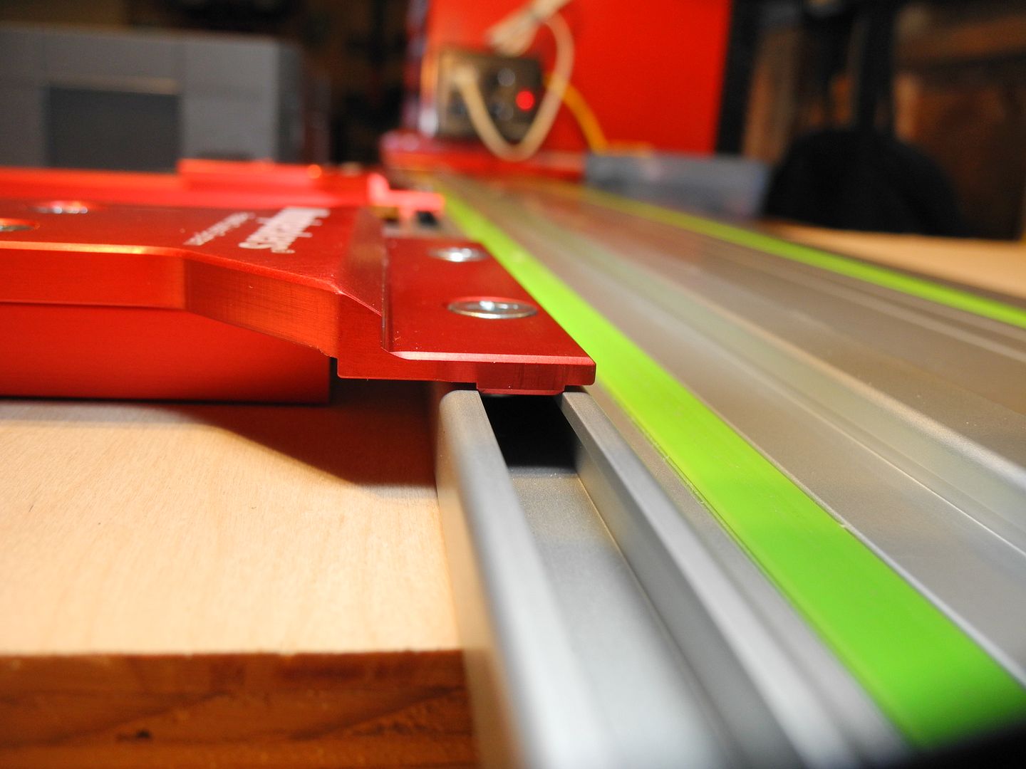

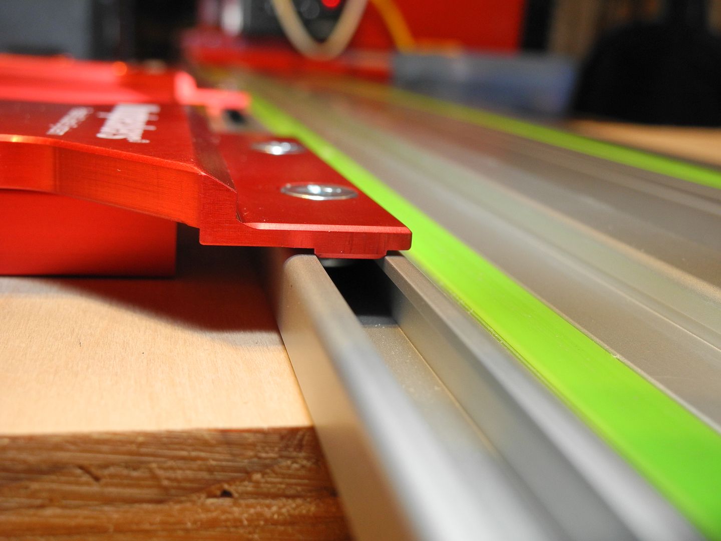

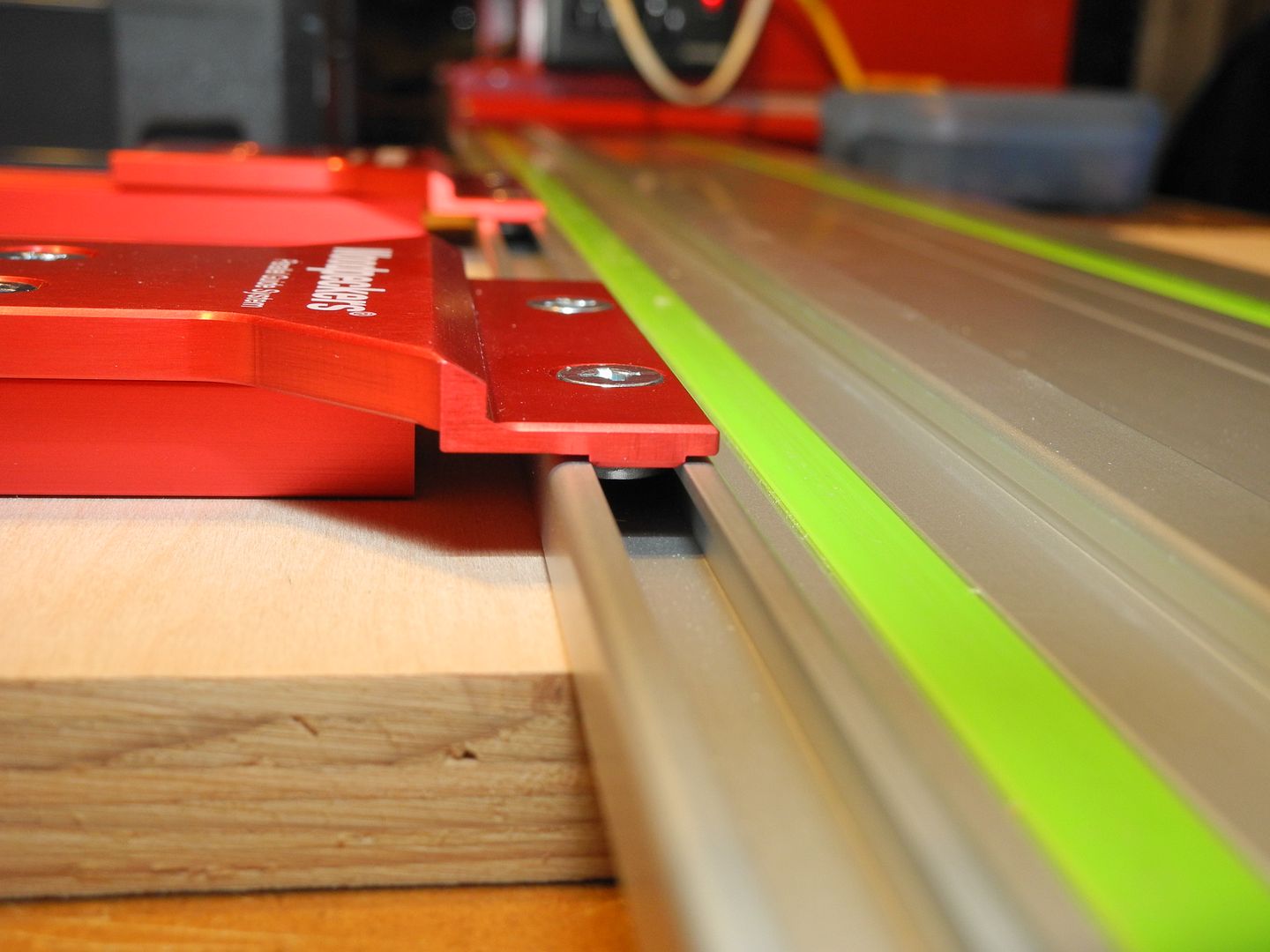

Here are some pics of mine in my shortest track, the one which came with the TS55. I picked them up a few times and placed them back down on the plywood sheet. The track does seem to move a tiny bit but the brackets position themselves back where they should be when placed back down. I did notice a LOT more movement when picking up the track itself and letting the parallel guides hang (only 2 sections are installed.)
The pics posted earlier in this thread by Jack and Cheese do indeed show that the bracket sits proud of the rail and certainly doesn't look centered. I don't seem to have that issue with mine. I've not tried my longer rail nor have I had the opportunity to make any cuts.
Take the pics for what they're worth - just another view of things. And that's as close as I can get the macro setting to zoom in on my camera.

Thanks for the post and pics Lunchman. Actually, mine centered OK it is just that with so little bearing surface between bracket and rail movement is inevitable and frankly I don't see the value it designing the bracket where it can somewhat easily be moved in the rail. That should be a solid connection in my mind since in order to use the set up efficiently one will necessarily be moving the assembly around.
