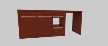

This is a cabinet I recently made for a client to fit an alcove in a recently built extension. The concept went through quite a few transformations before arriving at the final design. Carcasses made with beech ply wrapped in 50mm Eurolight board with MFC drawer fronts and doors. All joinery was done with the Domino which meant that 2 of the 50 mm Eurolight boards had softwood strips glued into one end. Drawers were made of solid Ash .. again jointed with the Domino.
All edge banding on the carcasses and Eurolight was 2mm ABS edging using Conturo. For the doors, drawers and shelves I used .4mm pre-glued edging tape. The Conturo made light work of all of this though I dearly wish Festool supplied a dark brown glue tablet. When working with dark material and especially as this also had a grain to it, it can leave a faint glue line which was difficult to remove.
