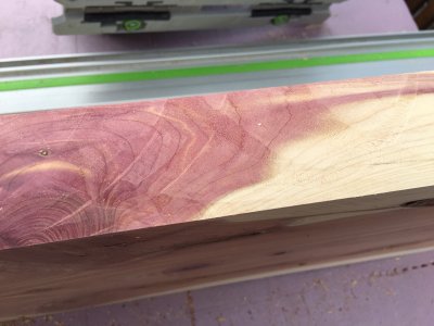

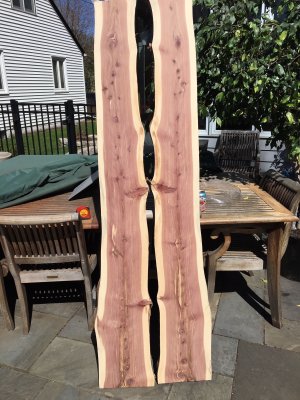

I've never had a performance issue with my HKC 55. Here's some aromatic cedar that was just under 1-7/8" thick that I used a 12 tooth Panther blade on. Aromatic cedar has a Janka hardness similar to mahogany, cherry & teak.
