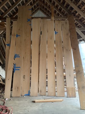

I ripped all of these floor boards to final width and changed the HKC's battery twice I think. Sailed right through using long rails and the dust extractor.

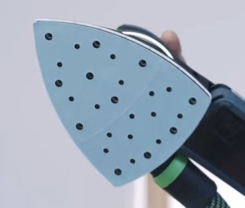

If you pause the video at around 11 seconds, when he moves the sander to the wall, you see this:
Also, Festool explicitly says that when the tip of the paper is worn, you can rip off the front triangle and rotate it to get a new tip; see the pre-cut line. Delta 100x150 can't rotate. 93V can.
Maybe that tip is neither 93V nor delta 100x150; the hole pattern doesn't match either current existing format.
I think that's a whole new abrasive size. It's too "fat" to be the current Delta as on the DTS. I guess it's like "six inch" delta.

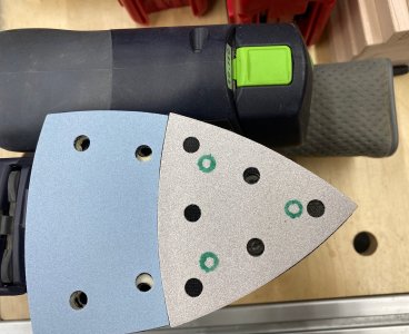

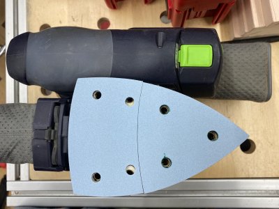

I purchased my first DTS in 2008 and then when the cordless version of the DTS was released, I purchased that in 2017. So by 2021, having used several DTS sanders for over 13 years, I realized I had gone through a lot of sandpaper "points" and decided to see if I could produce something better using the paper used for the DX 93 as the replaceable/rotatable "point". This is what I came up with back in 2021...it looks stunningly similar to the DTSC 200. 😵‍💫 😵‍💫 😵‍💫

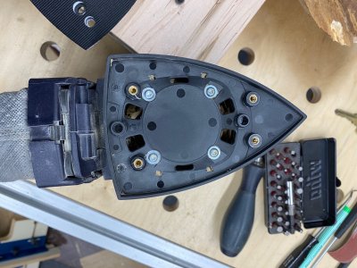

I started by removing the pad from the DTSC 400 to find where the dust evacuation channels went and then modified a piece of regular delta sandpaper and installed the "point" paper from the DX 93. The green circles on the "point" paper are the additional holes I needed to add to the DX 93 paper to provide proper dust extraction. It seemed like a good idea at the time.:ROFLMAO::ROFLMAO::ROFLMAO:

Looks like they should give you one of the new ones as thanks for inceptioning the idea.
