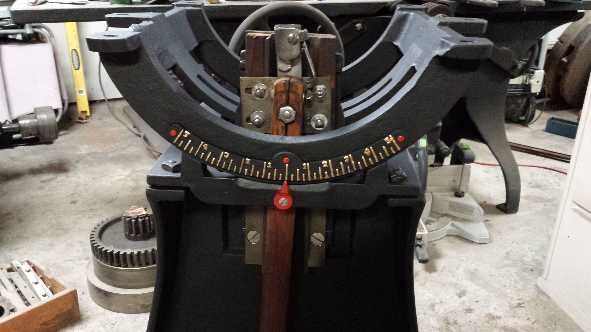

All the parts on the bottom are clean and painted.  I bet I have logged two hours in front of the parts slinger, er buffer with wire wheels.
I am still trying to clear the oil channel inside the drive arbor shaft.

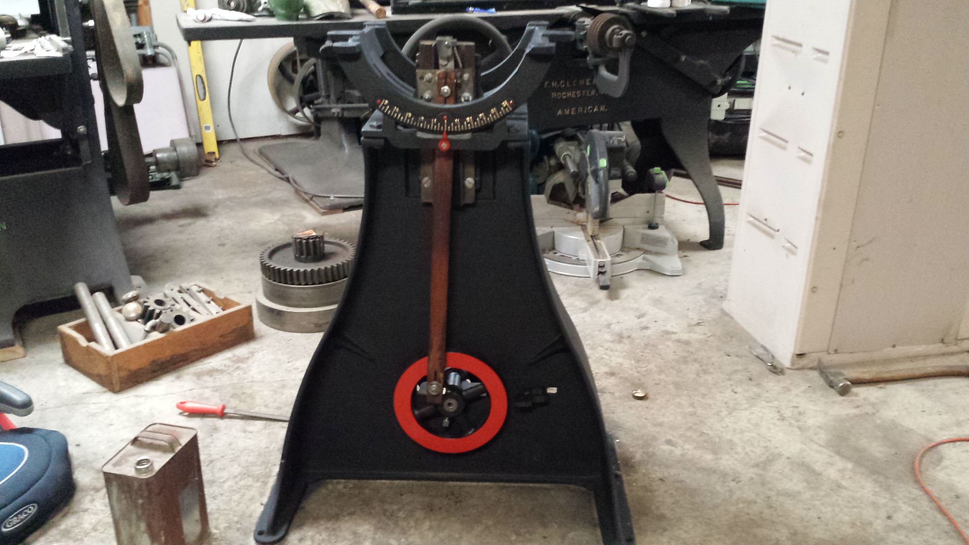

Made a little more progress.  Did some minor scraping on the lower bearings and got things loosely assembled.

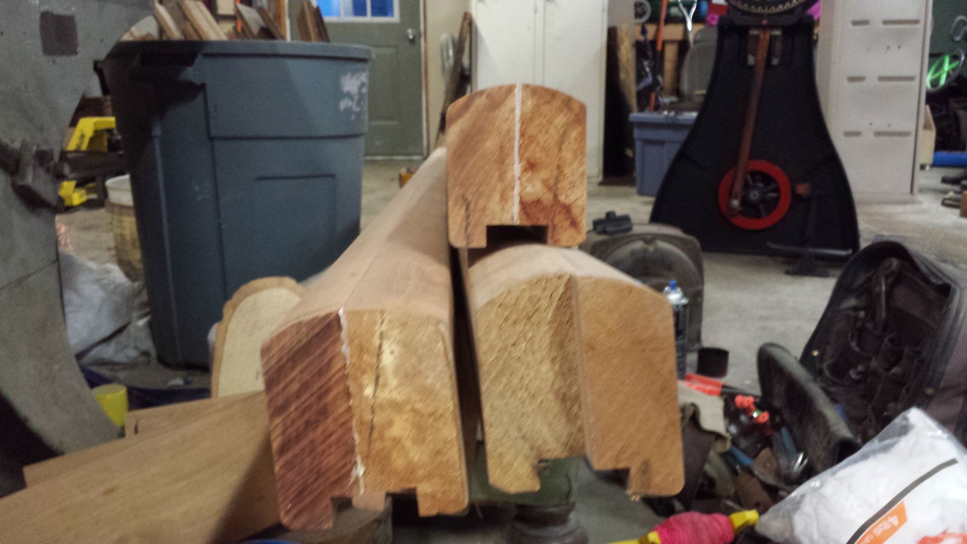

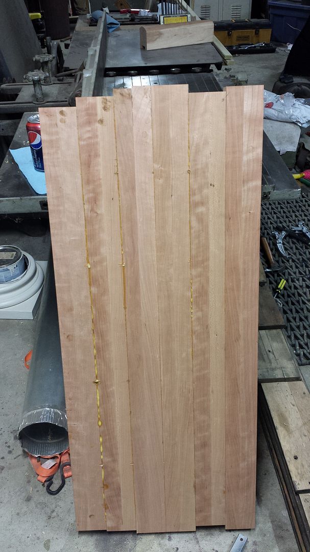

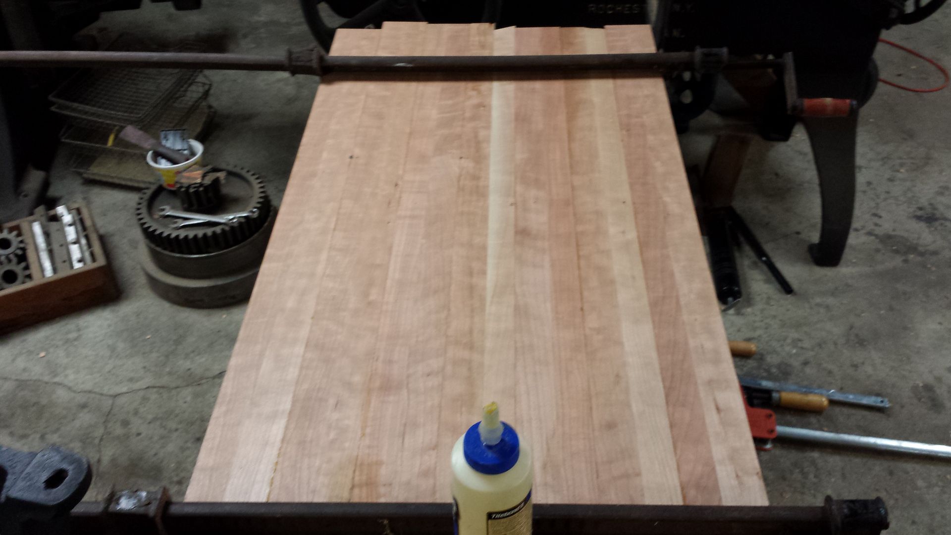

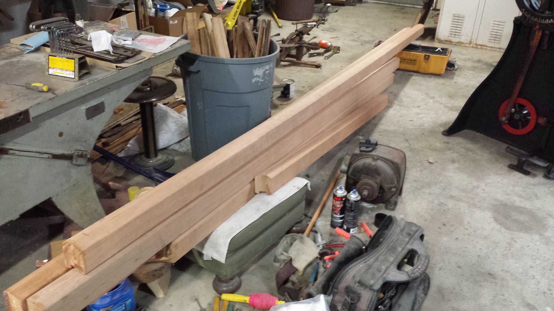

Bought a 100' of cherry handrail for 50 bucks at my millshop.
Table haves, I will skim a fuzz off in the planer, cut a few 10mm dominos and put the two haves together.

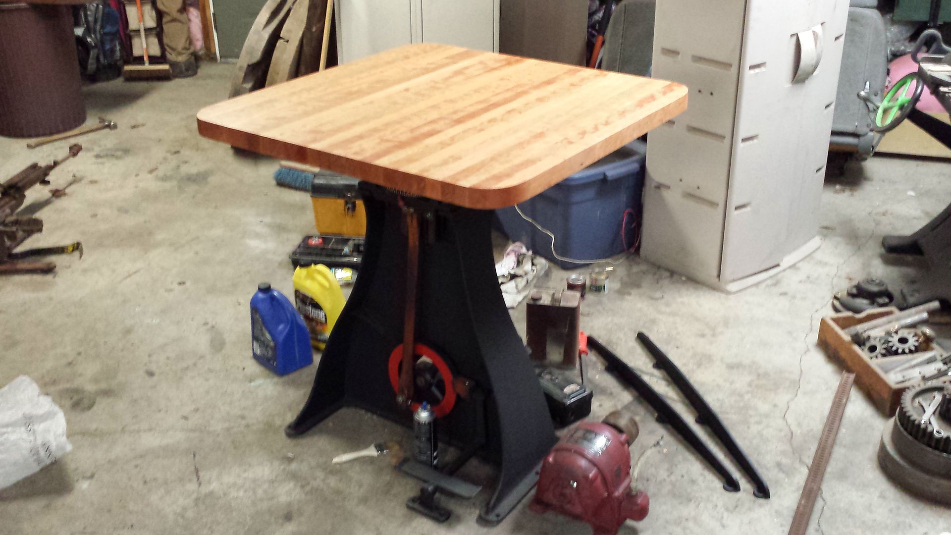

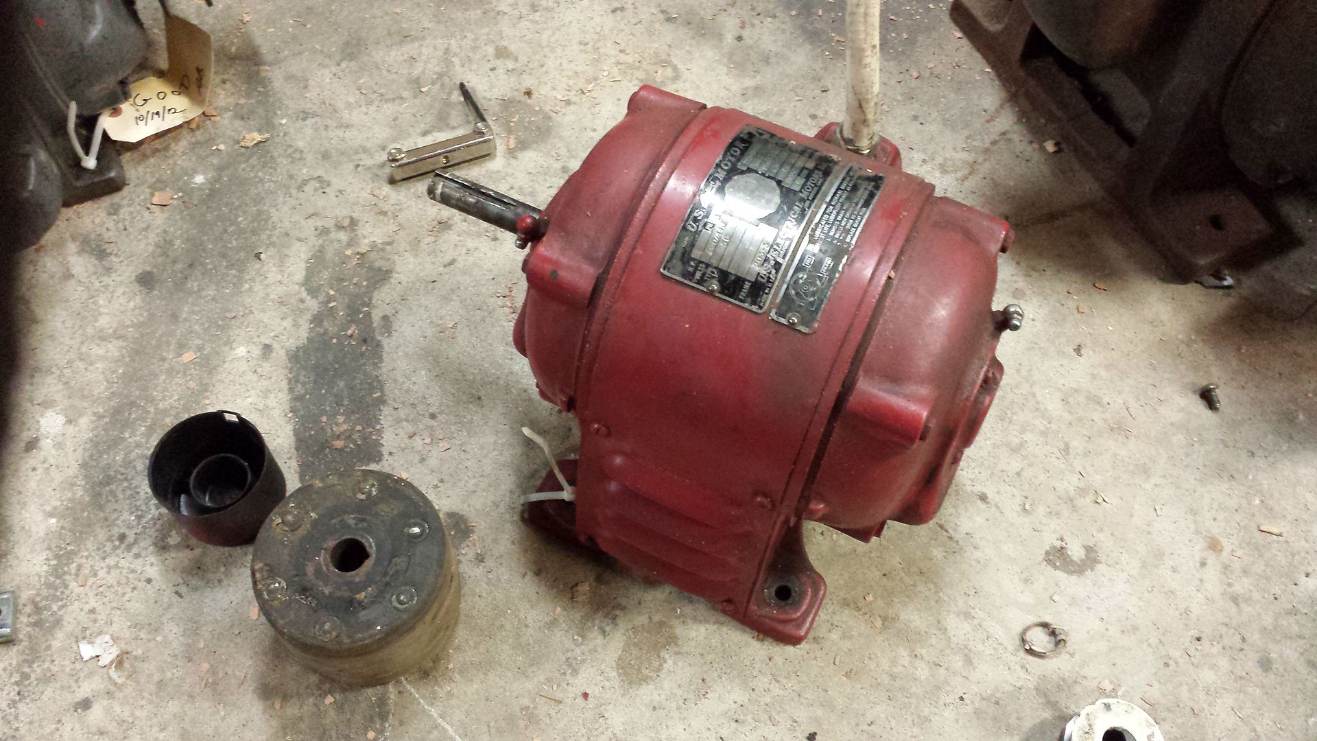

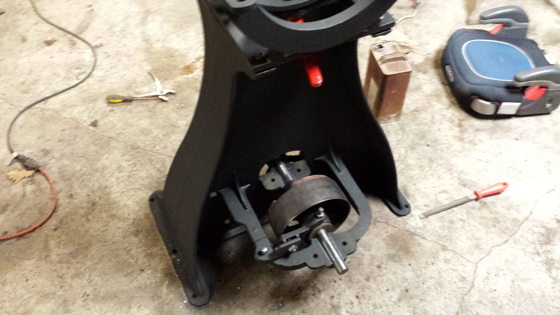

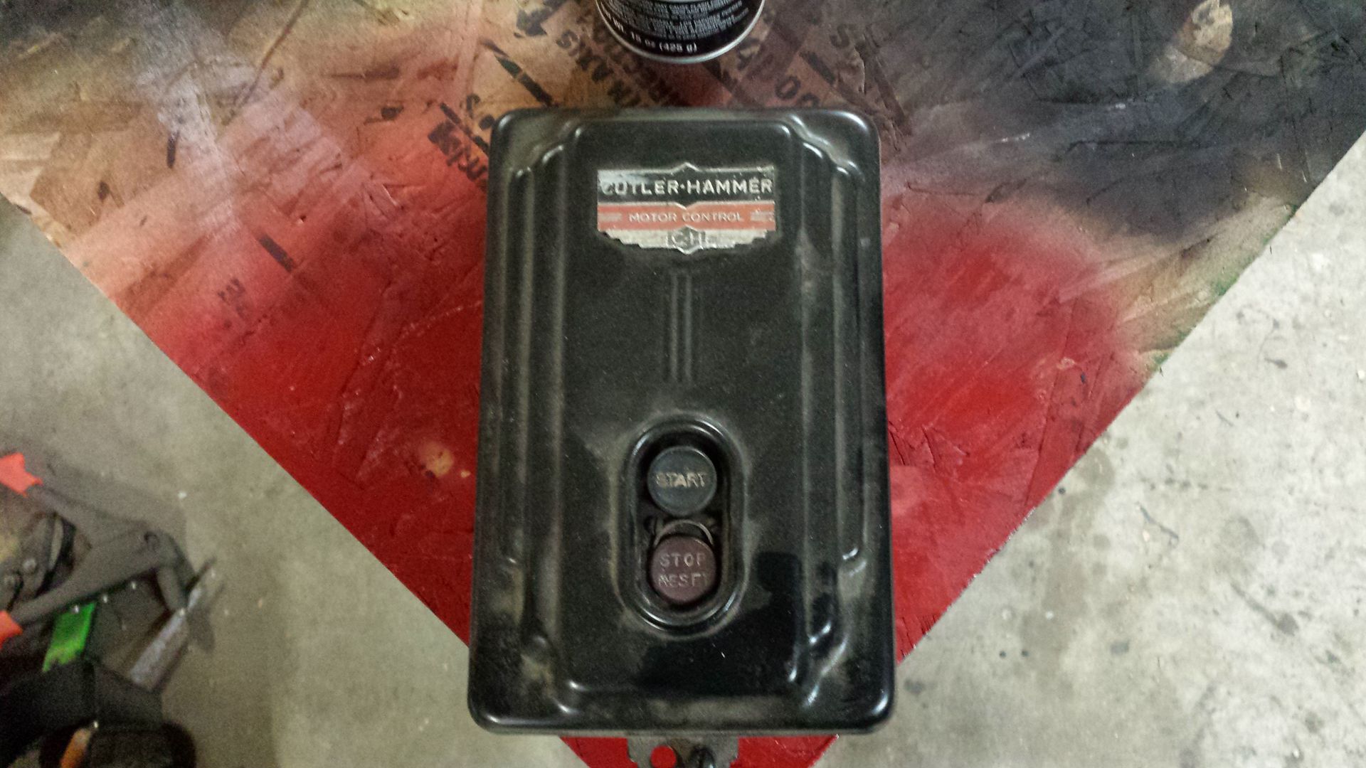

Table is almost done, I found what I consider an appropriate motor at my local industrial salvage place, found the right paper pulley in my stash and even found a starter in my stash.  Finding a suitable place to mount the motor may be a challenge as there is no clearance for the drive belt.
