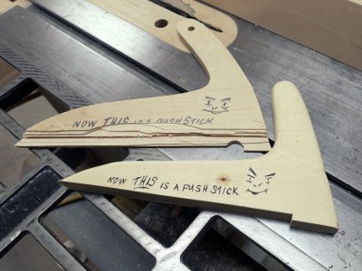

Wherever possible, I try to rip to width first and then cut to length, minimizing the possibility of kick-up.
Also, I design and make my own push sticks that both hold down the stock and push them forward.
Be forewarned: Those bright yellow plastic push sticks are risky. The can catch on the tip of the blade, bend and then explode when the plastic exceeds the modulus of elasticity (engineer speak for “can’t bend anymore bro—gonna explode..”
Wood, MDF and Particle board make superior push sticks, as the blade will grind away material instead of storing energy. Mine are large triangular pieces that both hold down and press forward the stock.
They are all made from scrap, work better and are safer to use than the commercial versions. I recommend you make your own.
Also, once I was “invested” in the process of making the push blocks, push sticks, etc. I found I was using them more frequently, and when I was not, I would design a new one to work better in that situation.
