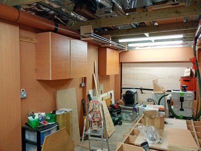

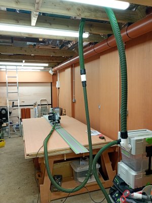

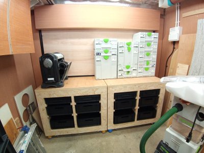

New electrics have gone in. There used to be two double sockets, now there's 18, so plenty of outlets to plug tools into.

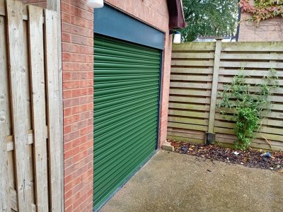

New roller shutter door went in, replacing the original "up and over" (or may be that should be "up and fall off runners") door.

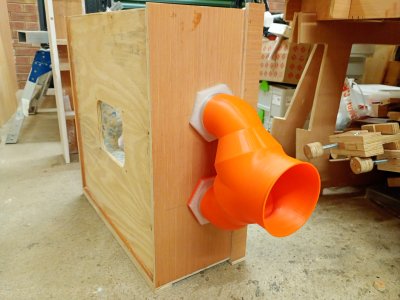

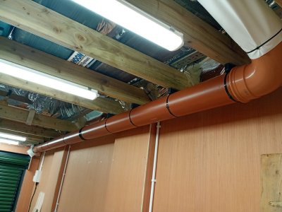

And I've installed an air filter system.

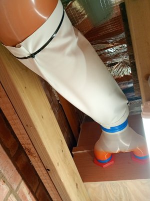

The air filter system pumps 1100m3/hr of air through a G4 and F7 filter. F7 is 50% retention of greater than 1micron. But, the garage is 60m3 volume so the entire air volume is filtered in 3min 16seconds. Or 18 air changes per hour. I'm pretty chuffed with the degree of over engineering that went into the system, and a lot of 3D printing.
