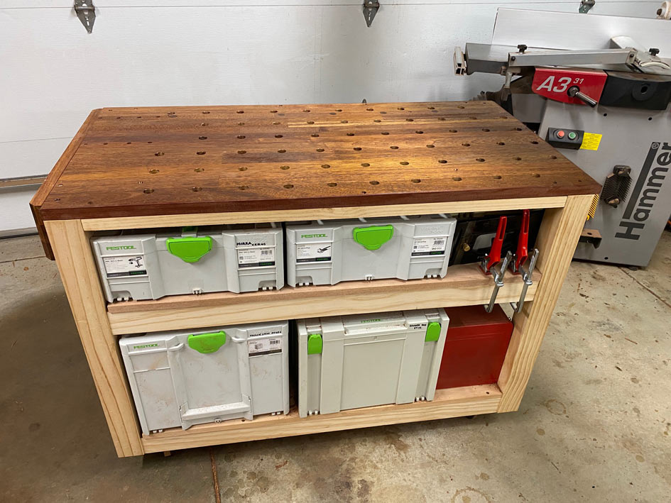

In the first segment of the MFT build, the aim was to construct a bench top that would accept the Festool accessories for work holding. The MFT would serve for routing, sanding, carving, and as an outfeed for a jointer, slider and router table.
The 20mm holes were routed using a CNC-made template.
It needs to be understood that the reason for making the MFT was partly due the cost of purchasing one in Australia being excessively expensive (the Festool MFT sells for $1595), particularly so when I am not sure how much use it will get.
