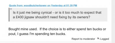

woodbutcherbower said:
Is it just me being cynical - or is it too much to expect that a £400 jigsaw shouldn't need fixing by its owners?
Bought mine used.  If the choice is to either spend ten bucks or pout, I guess I'm spending ten bucks.
