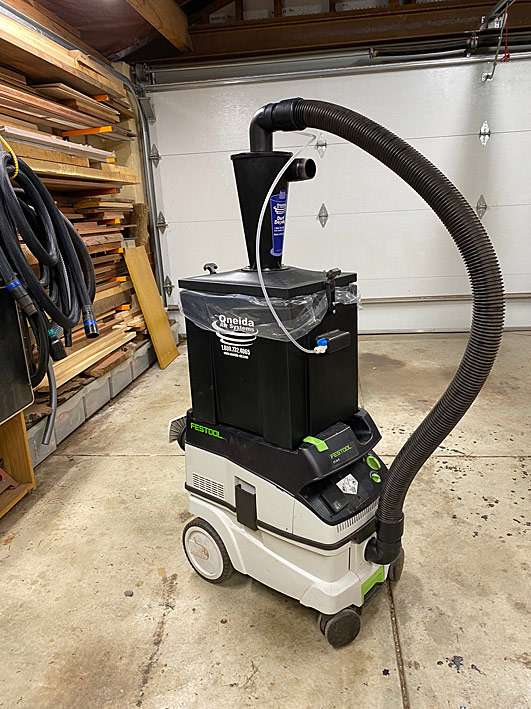

Hey there Cole. I've been following your festool videos on youtube (NW).
In your shoes here I'd do one of two things:
1. Use a separate shop vac and dust deputy setup. Cheaper and easier setup.
2. I'd skip the festool cyclone and get the oneida designed for festool vacs instead. The festool allows for more stacking of systainers, but the oneida has better performance and is a bit cheaper. In my shop I use a dd 2.5 with my dewalt vac. It's amazingly efficient. It will literally be years before I need to change the filter bag in the dewalt vac.
