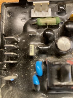

I have a 230V CTL 26 E, build year 2020 that when turned on, gave some arcing and a puff of white smoke and doesn't give a sign of life ever since.
I have taken out the circuit board and found nothing visibly wrong. No blown caps, no burned parts. The problem however... is that it is encased in epoxy (?). I have removed a bunch of it with a soldering iron, however, the PCB has some holes in it and the epoxy has flown underneath too, so I don't know how to free the board from it's 'basket'.
The potentiometer behind the main switch did have a funny smell. I have removed the epoxy around it and removed it's cap. It is from PIHER (probaby a PT15) and market 50K842M. I cannot match that to their naming topology however. I did measure the potentiometer and it ranges from 0 Ohm to about 14 kOhm. That is however 'in circuit', so that will most likely distort the measurement. Otherwise I would have expect 0 to 50 kOhm. This potentiometer tell the CTL to either be in auto or manual-on.
The problem is however, I don't have a diagram and the epoxy makes it impossible to draw one myself. So if anyone has it, or has had a similar problem before (and a solution) I would be happy to hear it.
I do have another (older) 230V CTL 26 E that I can compare measurements with. However, I am somewhat reluctant to swap out the PCB 1:1 in case the motor blew the PCB. The older PCB does have significantly less epoxy on it, but the entire surface is still invisible.
I could of course just buy a new PCB at €125 but for my wallet' and environments sake I'd rather just replace the broken parts. Like that potentiometer is only ~70 cents.
This is where I am at now;
Coen, it would be a simple matter to pull the existing pot out and wire in a new 50Kohm one to try, but are you sure it's the switch between auto/manual? Doesn't make sense to me to use a variable component as a switch, unless it's not a pot?
Not so simple because the underside of the PCB isn't accessible because the epoxy also went underneath it so it's pretty much 'glued' over a huge portion of it's bottom surface. So unsoldering the pot will probably result in it being destroyed. Then putting in a new one... maybe with a small pool of solder on each of the three holes, using three irons, then drop it in. Or I have to just cut a hole in the basket so I can reach the underside of the PCB near the pot.
Yeah, it makes no sense to me either, but since the main switch just does the same in both manual and auto (close the 2 poles) the potentiometer has got to be the thing that makes it able to distinguish between 'on' and 'auto'. Btw, the connector from the main switch has six poles and five wires; four to the switch and one goes straight to another contact on the same connector.
Also makes no sense to me that my working one gives between 40 and 50 Vac in both 'on' and 'auto' on the connector to the motor when you take the cable to the motor off. Once connected it's 230V on full blast and 113V on the lowest setting.
You could just cut it out and solder to the legs from the top to try a replacement. You'd then be able to confirm the value out of circuit.
I know this post is old but I’ll give it a try. I have a CT 26 E that I recently bought used. They were selling it for parts because it only worked intermittently. I plugged it in and it worked. I decided to take it apart and have a look inside to see if there were any lose connections or if it was really dirty.
I cleaned it all out and noticed that the brushes were about half worn. I ordered new brushes and waited. I replaced the brushes and now it won’t power up at all. I checked the voltage at the motor and it’s only getting less than 40V. I should note that I live in the Us and therefore have a 120V model. I checked the voltage at the two pin connector on the PCB under the control panel and there is only like 4 V going on those pins in both auto and manual. I’m not sure how much voltage should be going there because those wires are fairly thin and I can’t find any schematics. I don’t want to pay $170 for a new PCB because if it isn’t the problem, Festool won’t let me return it.
I’d appreciate any help anyone can lend me. Thanks.
