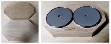

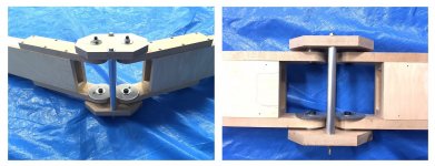

OK.  Made the articulating section out of wood.  Took very little time.  It ended up looking like this and worked perfectly.
For this, I had the 2 gears and 2 inch OD angled thrust bearings x 4 (links previously posted), two 3/8 hex bolts that were 12 inches long (Ace Hardware), some M10 hex bolts, some fender washers, and some lock nuts for the M10 hex, a couple of aluminum tubes (any narrow pipe will do), some 1 inch maple and some 3/4 plywood.

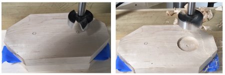

So.... first thing was to cut some 1 inch maple - 5.5 x 9 inches x 2 pieces and cut the corners at 45 degrees.  That has nothing do to with function but looks nicer.  If you want it to look even nicer you would do a 3/16 or 1/4 roundover and sand.  I made no effort to make them perfectly identical.  As you can see, if you were to put the gears on top, they would fit
[attachimg=2]
With the gears sitting on top of 1 of the maple pieces mark the center, and drill a hole around 1/4 inch deep with a 2 inch Forstner bit.

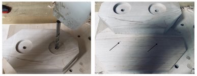

Then, keeping the wood clamped to the drill press table, change the bit to a 25/64 or 13/32 bit and drill the hole all the way through.  The center indentation from the Forstner bit is a nice way to know the center also.  This will allow a 10mm bolt to go through.  25/64 is adequate, but you can go 13/32 if too snug.
[attachimg=4]

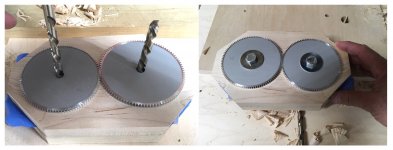

This is key.  After you drill the first hole, Take one of the gears and place it as shown and use a drill bit or a 10mm bolt to keep it in place.  Then place the other gear next to is so it meshes.  Then, use a 24/64 or 13/32 brad point bit and insert it through the center bore hole in the gear, and tap it to mark the center.  Then drill the 1/4 inch hole with the Forstner, then drill the other hole through in the center.  If you were to then place bolts through both holes, the gears will mech.  Essentially, you are using the gears to mark the distance between them rather than a ruler.
[attachimg=5]
Now, on the left you see the 2 Forstner holes and the 10mm or so holes in the middle which are the prefect spacing for the gears to mesh, but we need to duplicate that on the other piece.  So, we put 1 on top of the other, and then use the brad point bit to mark the center.  On the picture on the right, the black arrows show the indentations.  For that piece, you drill the Forstner 2 inch diameter holes and the center holes.

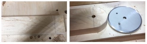

Now, take 4 pieces of 1 inch thick maple 14 inches long and 3 inches wide and mark the center 1 1/2 inches before the end for each piece.  Drill the hole in that marking with the 25/64 or 13/32 bit and round the corners.  The center marking does not have to be perfect.
[attachimg=7]

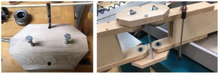

Now, drill 2 holes for the 3/8 long bolts as shown. Once you do that, then pub the 2 pieces on top of each other and do that same tap with the brad point to mark the corresponding location on the other piece and drill.  Then you assemble as shown on the right.  For this prototype, I used some 3/4 plywood for the arms 6 inches tall and 3 inches wide.  The 4 pieces of 1 inch thick maple were screwed to the arms.  For the undersurface of the top 2 of these, I drilled a hole in the gear and screwed it to the maple with a bolt running through so the gears would be centered.
For the assembly, on the top, you have the top plate and the bottom plate with the 2 inch OD bearings seated into the wood (courtesy of the hole with the Forstner bit).  Under these plates, you have the extension pieces of maple connected to the boom arms with the gears under the top extensions.  Through the holes you have the 10mm bolts and washers and lock nuts.

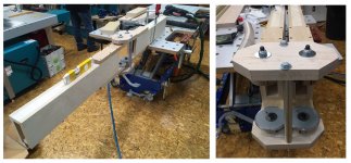

[attachimg=8]
I clamped it to the bench and tested it.  Worked perfectly.  I added 20 lb barbell plates to the end.  No deflection.  I lifted it up 7 ft and dropped it on the floor, no damage.  I swiveled it side to side and it never moved on its own but no resistance either.  No wobble or sag.

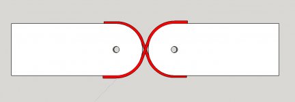

If you want to simplify the design, you can replace gears with straps or cables as shown below (red). Straps attached only at the ends and transition from one curve to another. This principle is widely used for symmetric rotation from children's toys (Jacob's ladder) to industry.
[attachimg=2]

Thanks Svar,
If you have a link to a particular product for straps you recommend as a nice durable option, I can try it.  That would be as easy as unscrewing and removing the gears and adding the straps to see how well it works.  As far as design, I believe it is simple very simple to build with clear detailed instructions and a materials list now that the bugs are worked out.  The gears are just meshed together, and that guides where you drill the holes on the top and bottom plates. That correct spacing is all that is needed to insure the gears work when secured to the boom arm and the center section is assembled.  However, the if straps have identical functionality, and are less expensive, that sounds good!  I already have the gears and it already works, but as I said, I want to see just how easily it can be made at a low cost without compromising functionality and durability.  Therefore, happy to experiment so others can save $ if it works.
Perhaps a discarded fan belt picked up from a repair shop would suffice to test with?  The composition / lack of stretch / strength / ability to drill through for fastening etc. should exhibit the properties of a similar premium product.
