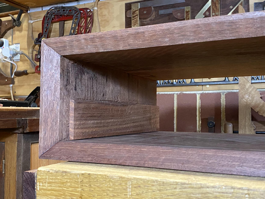

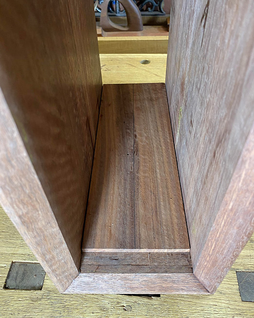

Frankly, the hardest part of this section of the project was accurate marking out of the two central drawer dividers. These need to be both perfectly parallel, and also aligned vertically (the lower panel with the upper panel).
There is a second area that needed to checked, which is important for drawers to work well, and this that the lower panel is flat - that is, does not have any hills. I learned my lesson the hard way about this. All good.

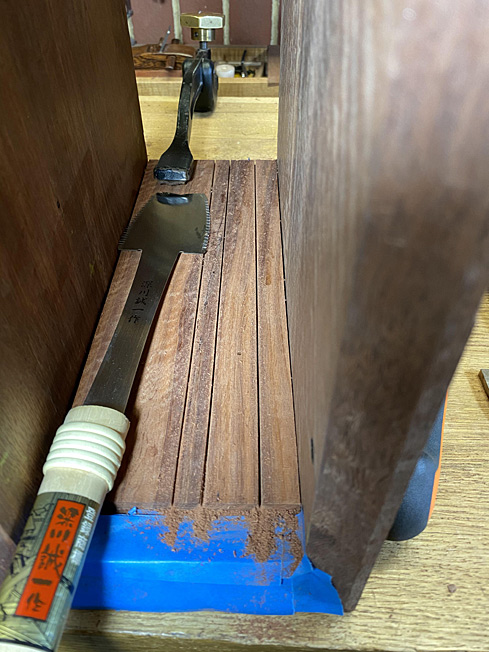

The way I go about marking the dados for the dividers is to make templates for their position. These are used on both the lower panel, as below, and then the upper panel ...
The process is self-explanatory ...
The dados are knifed deeply ...
Chisel walls cut ...
.. and then the waste is removed with a router plane ...
The dados are just 2mm deep. That is deep enough to prevent any movement. This process is quick and relaxing (compared to setting up and using a power router).
Once done, the process is repeated on the upper panel ...
All ready for a dry fit. The rear of the case ...
... and the front ...
Happily, all is square ...
Tomorrow I shall glue it up.
