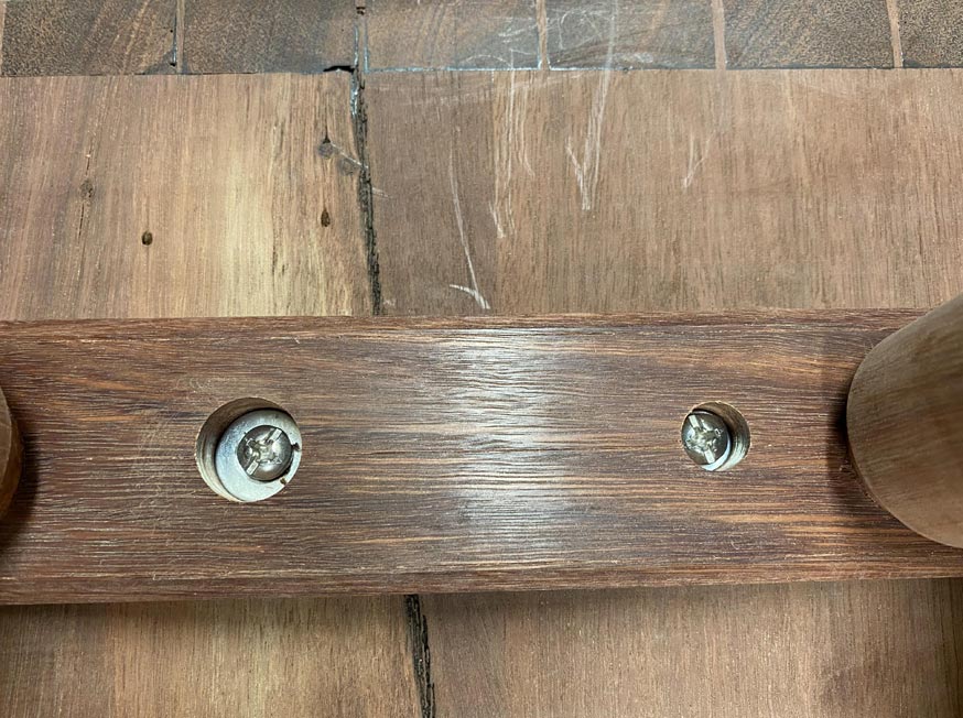

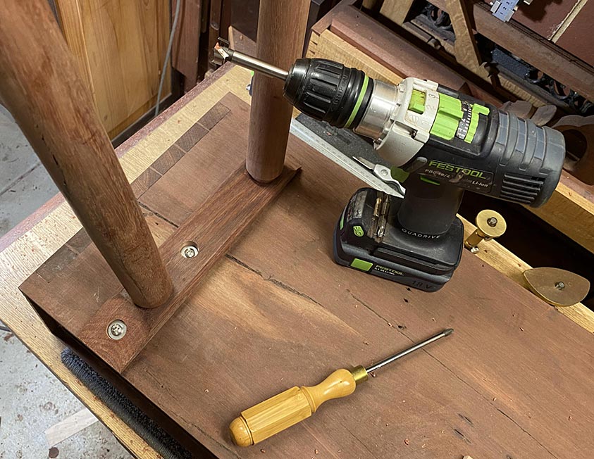

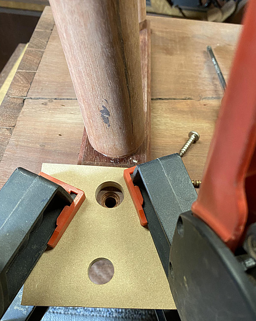

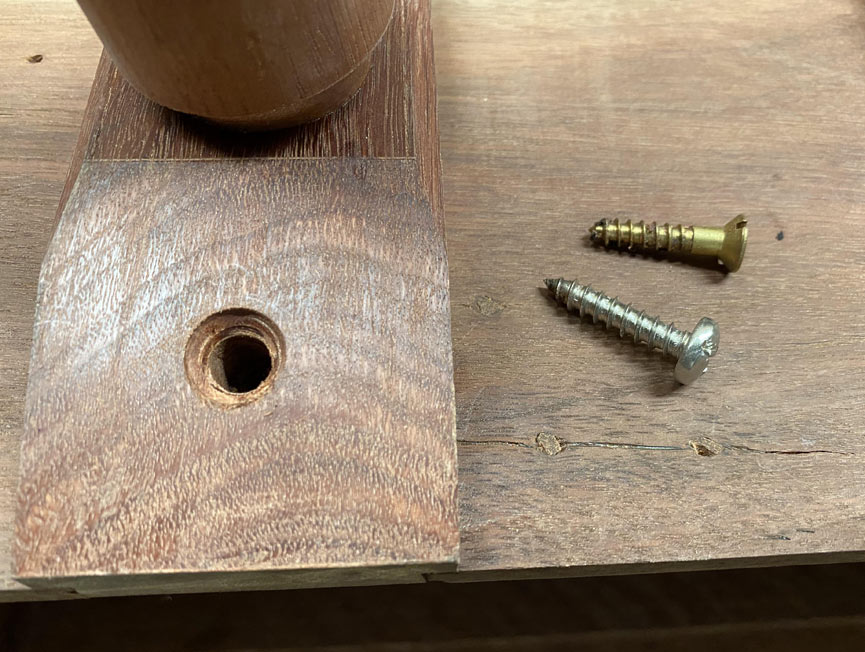

Okay, so I decided that the wood screws were a mistake. They would prevent movement rather than permit it. So they had to go.
This is the exchange screw: a 12 gauge stainless steel wood/metal screw with an all-important flat/domed head.
The plan was to use a 3/4" forstner bit. This would leave a wide, flat area for the screw head to move along. The range of movement would be the same as before, about 2mm each side of the screw.
A MDF template was made to guide the forstner bit, as it had no support in view of the existing hole ...
Drilled to depth ...
A steel washer added ...
Done ...
I had only 15 minutes after work today, but on the weekend, when I get back to this build, I plan to add a third screw behind the front leg.
I put the last screws in after work. That will free up this weekend to concentrate on building the drawers.
There are three screws. The one at the toe is fixed and there is no play for any movement. The two at the rear can slide 2mm each way.

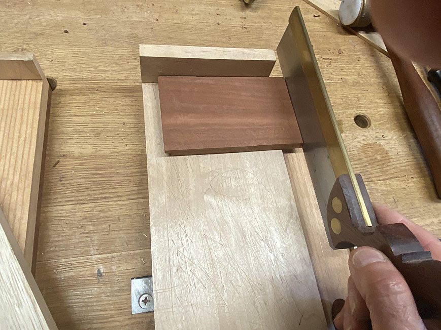

To make it easier to see what I am sawing, I am using blue tape ...

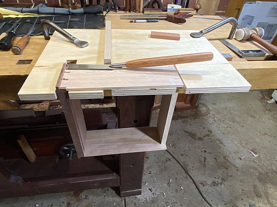

And that is where it stops being straight forward as this is as much as it is possible to saw inside the lines ...

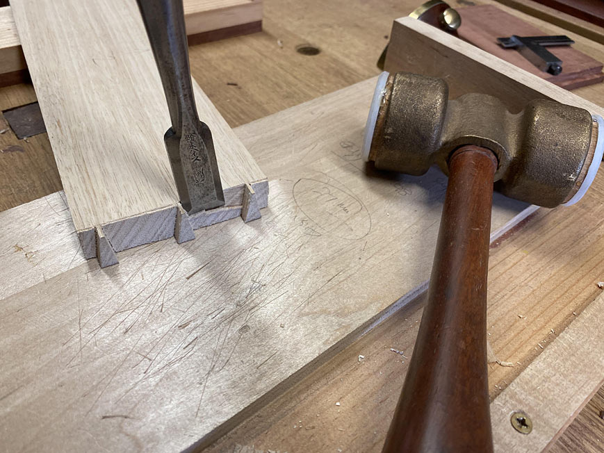

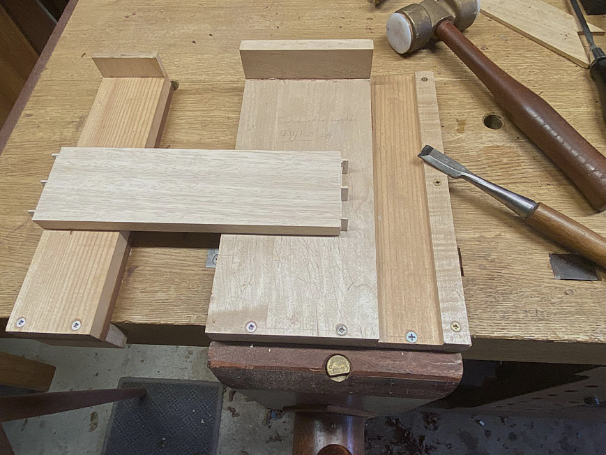

I decided that, if I could not saw it, I would chop it. This gives new meaning to "chopping dovetails" :)
The pin board is clamped (to avoid any splitting), and the kerfing chisel is used to deepen the existing half-kerf, and then extend it across the socket ...
Now the waste is chopped out ...
This picture of a fishtail chisel cleaning the corner of the socket is for bill :)
Does it fit? Oh, the suspense!
Two more to go.

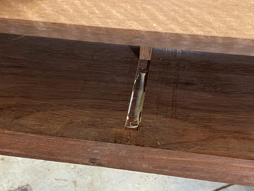

Fitting the drawers also required positioning and glueing the drawer dividers. These also act as drawer stops ...
This is the drawer divider in position ...
It is slid back ...
The first third of the dado receives glue ...
The drawer is replaced and positioned ..
And then the drawer divider is slid up against the rear of the lip ..

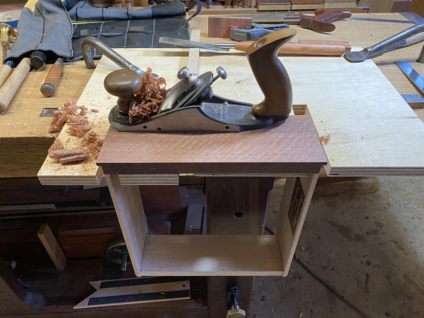

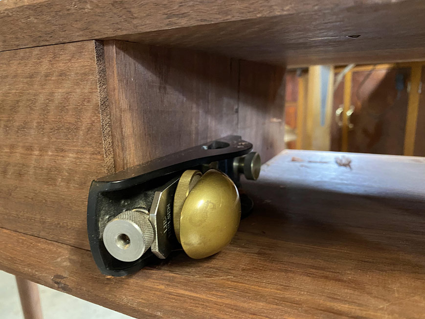

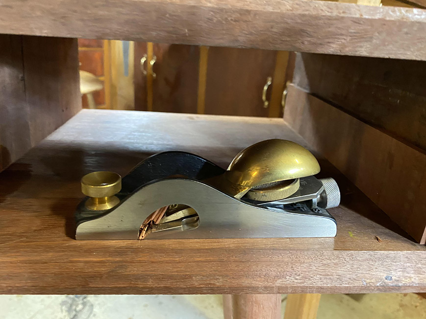

The drawer case is fine-tuned with the LN Rabbet Block Plane ...
This is used to smooth over any irregularities in the side walls and, where necessary, to plane away any fat ...

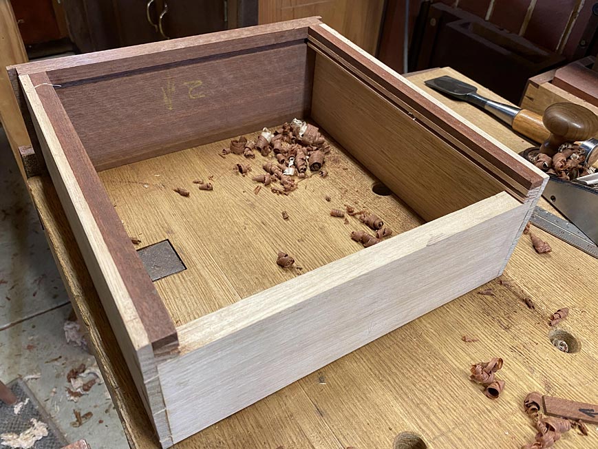

The drawers are in the process of being glued up. Drawer #3 cannot be glued up until a brass plate is recessed  into one side. T

The drawers are now glued up.

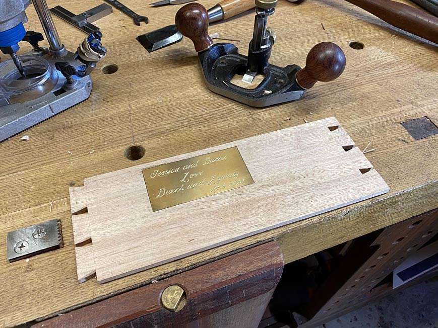

Really, really nice, Derek!  I especially think the plaque is a nice touch.  Can't wait to see the finished pics!

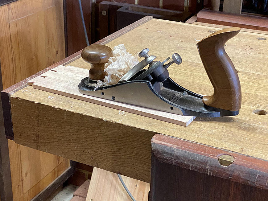

The tongue is planed ...
The fit is tested with a spare slip ...
The bottom was about 1mm too wide to fit. A LN edge was perfect to re-joint one side ...
Re-establish the tongue with a shoulder plane ...

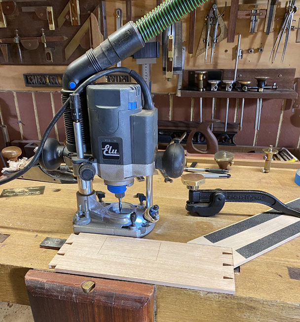

Nice to see the MOF-177 earning it’s keep, I have one in good order that mainly sits in a router table. The other is brand new unused in it’s original box, on a shelf in the workshop (at least 30 odd years old)
I don’t know why we never used it? I think I bought two together and a recession hit, so work volume slowed, and it’s sat there ever since.
As you know, they’re are great routers.
JJ, the Elu177e is an excellent router. That one was purchased 30 years ago. I do have another in a router table ..
As you are probably aware, today these are sold as the DeWalt DW625.
Hi Derek, yes I’ve bought a few parts (dust extraction port etc) under the De Walt DW625 listing.
Still prefer Elu grey to De Walt yellow though  [wink]

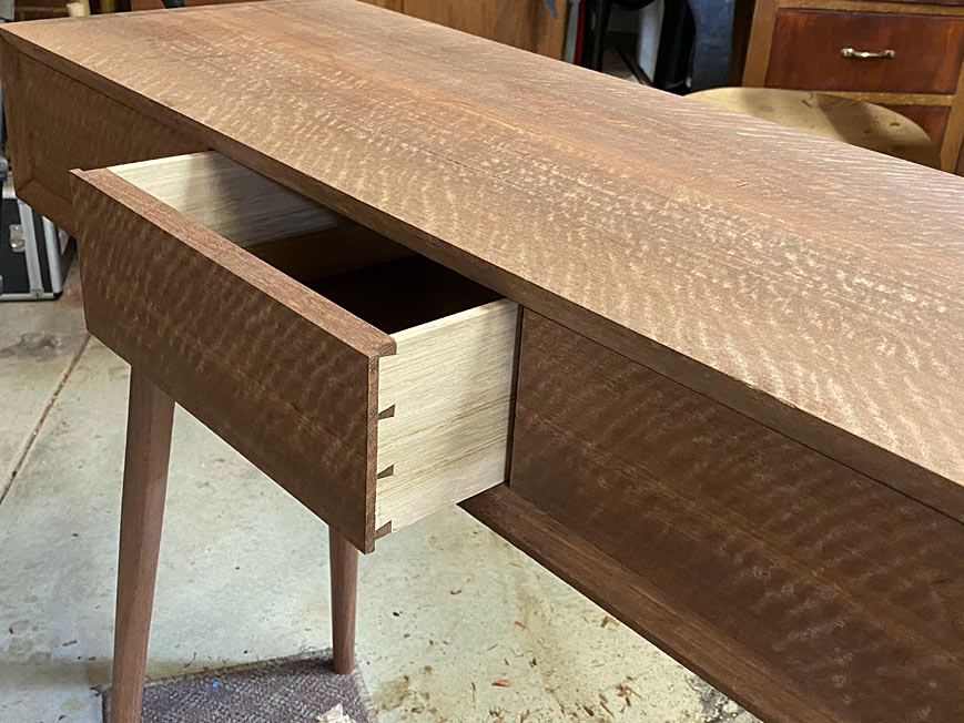

Okay, here it is. It is photographed in my entrance hall  ....
The wood is fiddleback (curly) Jarrah.
A close up the waterfall on one side ...
... and on the other ...

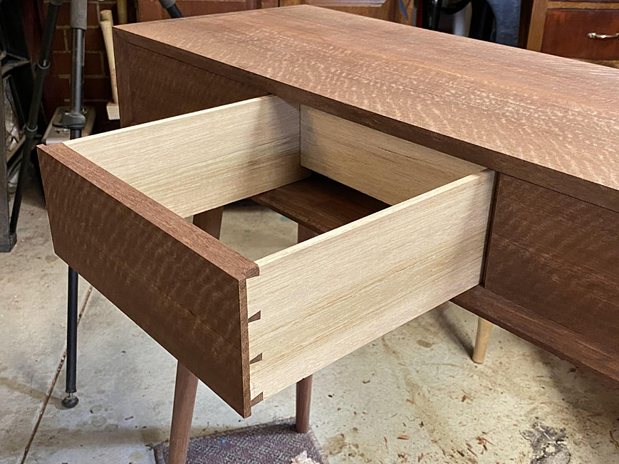

The obligatory dovetail shot ...

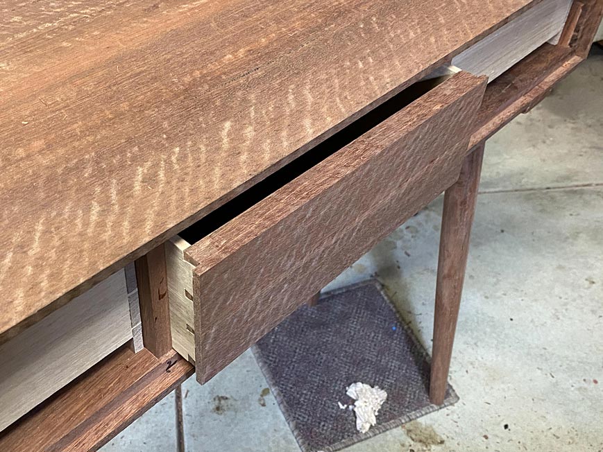

Those drawers! The lipped drawer fronts are 20mm, with the drawer sides 1/4". The back is 15mm thick. The thin sides necessitated drawer slips. These were beaded to create a transition from slip to drawer bottom. The drawer bottoms are 1/4". The wood used here is Tasmanian Oak.

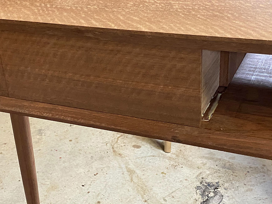

Since the case and internals are build from hard Jarrah, the underside of the slips was given a Jarrah slide to improve ware properties.
As mentioned earlier, the aim was to present a single board at the front ...

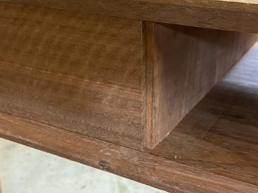

Here may be seen how the lips share the drawer divider and use it as a drawer stop. The spacers at the side of the case are half the width of the dividers as they do not share two drawers.

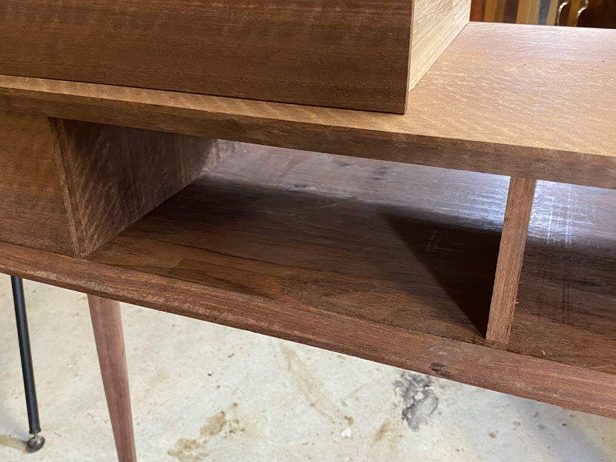

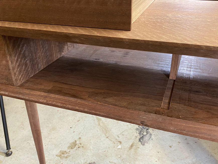

The internal bevels around the case ...
... maintained a straight edge to the drawer line. Plus the gap between the drawers (about 0.5mm) ...
