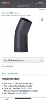

I too forgot to mention not seeing a curved 50mm part, not even in the 50mm hose and attachments set. I find it oddly, as I purchased a CT 26 lightly used a while back, with a lot of accessories in the hose and attachment department - and in this systainer where all the loose  parts were I found a curved 50mm plastic piece. There’s no stamp or print on it, but it fits perfect to Festool’s 50mm inside and outside (depending on which way you use it) I am pretty sure it’s a Festool item, but later I have never found one.

Guys, I was wrong - I did find a part no’ - It’s a Bosch part:
Beware: It is the narrow end that fits inside the vac side of the hose - as I do only have a couple of 50mm hoses, I haven’t had the opportunity to try it on the wands. That said, there’s a chance it won’t fit the wand (without heating or sanding)
It has the same appearance as Festool’s and Nilfisk..
