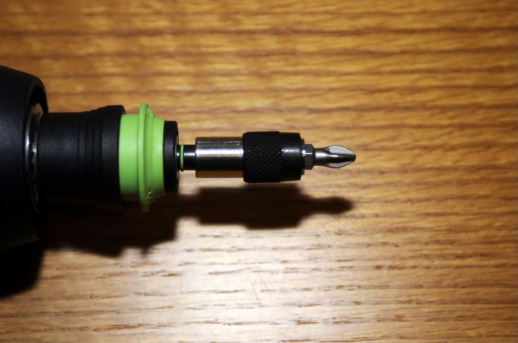

Bits, just some pics of the bits. I was surprised at how well the short locking extenstion from Festool works. It has a neodium magnet inside, and it locks both wide detent bits and ball detent bits very securely. The Centrotec bits don't wobble at all, due to the long shank in the drill. The extension is like this, and it holds bits in it's end better then all the non-Festool extensions I have. At $26.50, it was crazy expensive, but awesome. I included a pic of the cool extension, and a Centrotec bit, each installed in the Centrotec chuck.
Last is a pic of a Centrotec Philips #2 bit, and the short extension and a Festool wire detent bit.
