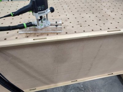

You just need a bigger sub-base, something well over the width of the pocket, makes it simple. Taking the fences off of the acrylic edge fixture works for me. The retail version is fairly expensive, but anyone should be able to replicate a functional version. I know I have a better pic of that thing, but I can't seem to find it.
I actually have one of the standard bolt-on router table inserts I use as a large base. I just have to pull my finger out and make some new MDF templates. I made perspex ones but stupidly put all the pockets on the one sheet too close together. Not a good idea.
