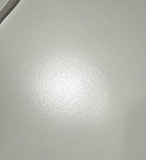

Here is a sample of what I'm getting.
BM Advance, no thinning, colour is Stone Harbor # 2111-50, sheen is pearl ( satin in the US ) tip size is FFLP 314. Airless is Graco Ultra Handheld.
That is what the entire panel, 18"x24", looks like. Any ideas on what is going on?
The image of the sun is my light reflecting off the panel.
Thanks,
JC

What is the substrate? What primer are you using? What grit sand paper are using before spraying Advance? After you finish sanding are you wiping the surface with a rag or blowing it off with compressed air?
It’s also possible that the issue has something to do with your spray booth. Maybe you exhaust fan is pulling too much air when you’re spraying?
Have you discussed the issues you’re having with your BM rep? I’d recommended having them visit your shop and watch you spray a sample.
I’d also try using another product from a different manufacturer. If you get the same results than at least you know it’s not the paint that’s causing the issue.
After spraying the paint does paint look like glass when it’s wet? When do all the micro bubbles appear after you’ve sprayed the paint?
If you have ever been to a skating rink, the paint looks like when a Zamboni just finishes cleaning the ice. Wet as a lake. The bubbles appear almost immediately when tha paint hits the surface. It really gets bad after about 15 minutes of drying.
JC
I’d guess your paint was reacting with the primer or fillers you’ve been using. Either way it’ll be interesting to find out what the fix is.
Send me a tin of the paint your using I’ll spray with it and see if I get same problem.
Or better still see if some one local to you will spray with it.
