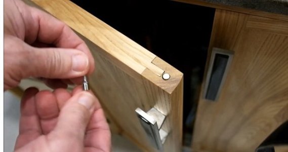

I don't think this method is for me, but I did find an interesting idea on Youtube.
He finds that one magnet in the door and one magnet in the cabinet makes the magnets line up with centers exactly aligned (as opposed to one magnet and one steel striker, which does not position the door as repeatably, according to this fellow.
