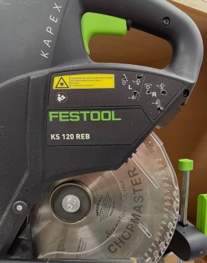

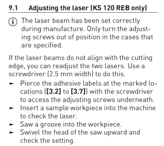

I just got a brand new Kapex 120 to replace my old Craftsman and before using it I thought it's a good idea to check the calibration, following the instructions from the Supplemental User's Manual. Miter, bevel and laser to find out to my disappointment that only the bevel calibration was right out of the box.
I fixed the miter calibration. I have to fix the laser calibration too, but I have a hard time thinking that I'll have to punch through the decal to get access to the screws. I assume the reason for the adjustment holes to be covered by the decal is because this is not supposed to be a calibration the user should have to do and also to keep dust out.
I guess my question is: is it ok for a brand new expensive tool not to be fully calibrated out of the box or is the legendary Festool quality going down?
I, too, had to calibrate my EB to get what I wanted for the square cut/miter and laser settings (the bevel was dead-on). I don't think dust will be an issue because of the holes -- and those holes can be easily taped over, if desired.

Problem solved. Fortunately the instructions on the supplemental user's manual are very good, but unfortunately the side of the saw now looks like something bought at a garage sale and not like a brand new expensive item I bought a week ago.

I just tried to think of it in terms of 'getting to know my machine', and calibrating it carefully myself was part of that process, and so also means I know how to recalibrate it again later.
I agree it was dissapointing I had to puncture the decal to do it, I feel like they could have pre-punched holes themselves, or at least partially pre-punched, or made the bigger label in two parts so the place you need to make the holes can be pre-cut where the holes are (and aligned more easily by the person sticking the decal on).

The issue is not that I had to calibrate it, that was just disappointing, the issue is how it looks after I had to punch through the decal, it's a mess.

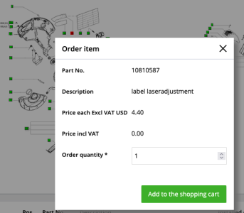

If the condition of the label is a problem, replacements might be a few mouse clicks away.

I assumed the reason they choose a decal instead of a more direct access to the setting screws was to protect the laser and the calibration mechanism from dust
I have always thought it was weird to have the adjustments behind the sticker. Always seemed like a very “un-Festool” design decision to me. Or maybe they consider the sticker sacrificial like and MFT top 😀
It never seems to impact anything other that the appearance of the side so I guess it is what it is.
