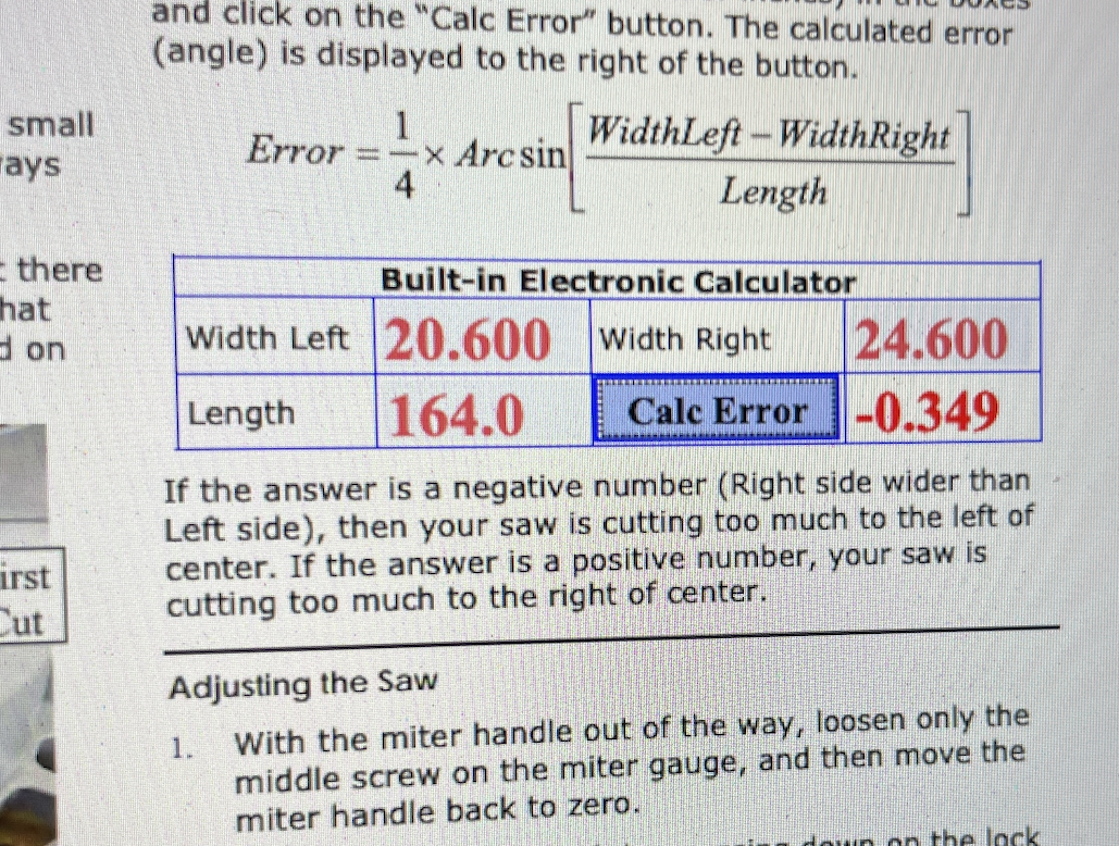

After spending possibly way more time than i should have, i modified both the vertical and horizontal cutting setups.

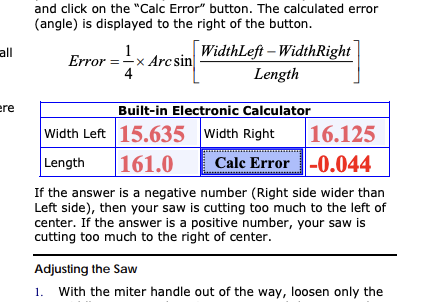

Horizontally using the 4 cut method in the manual, the result was .06° out.

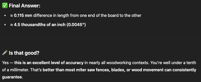

By the time I stopped stuffing around going backwards and forwards, I got it down to .01° ( from .8mm difference end to end down to .1mm) and called it.
