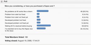

Untidy Shop said:
Is this the 2016 reality? I have no reason or evidence to suggest yes or no. But does this Thread reflect these 2008 statistics? I find the 32 and 19.3% the more interesting statistics.
From -http://festoolownersgroup.com/festo...x-problem-poll/msg447881/?topicseen#msg447881
As a Q&A stat that looks like "noise".
I do think the reality is that we've had several very public failures in a pool of unknown relative engagement. I hate to draw on NPS thinking, but the climate is definitely provoking - but in no way conclusive.
