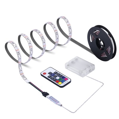

Better yet, this US$13.56 (shipped) 3 AA battery-powered self-adhesive LED light strip kit (w/remote control!):
[Source:https://www.ebay.com/itm/Battery-Po...868?_trksid=p2349526.m4383.l4275.c10#viTabs_0]
You could change the color of the light depending on if you are working with light or dark woods. :-)
These lights don’t bend to the radius we would need if installed to point down at the work.
