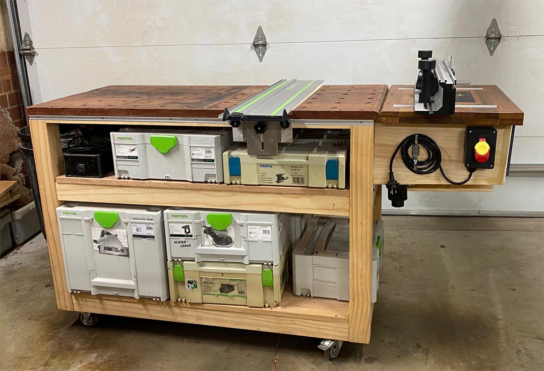

I use the Makita trim router in this ...
Boxed in to increase dust collection (via fence and from below). shown with earlier fence ...

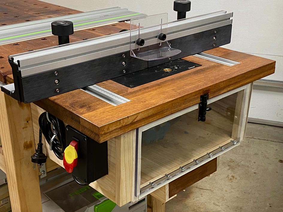

Access via the front ...
The 1/4" collet has been swapped out for 8mm. This improved stability four fold.
