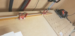

The fence is rock solid. You could use bolts through those L brackets to make removal easier, but mine stays there full time, so I didn't worry about that.

How did you get that flip stop to work? were you able to somehow reverse the locking plates?
No, it fits on the fence as is - but, because it's designed for the higher fence, when the stop flips down it hits the table top before it hits the fence - you can't use it as a stop for narrow pieces. (It usually goes with my Incra mitre gauge, on my router table)
He's turned the "flip" around. The racks are on different sides on the Incra Track and Flip fence. Here's the original...

I made a slightly larger workbench with the PGS V1 a few months ago. 140cm x 80cm. A fence with a flag stop is very nice to have on hand for repeatable cuts.
I would recommend you either go big with an Incra track and shop stop or a cheap veritas extrusion with the veritas flip stop. It makes the mft style bench much more capable and fast. I also recommend something to hold the dogs secure from bellow the top for better accuracy on cuts.
