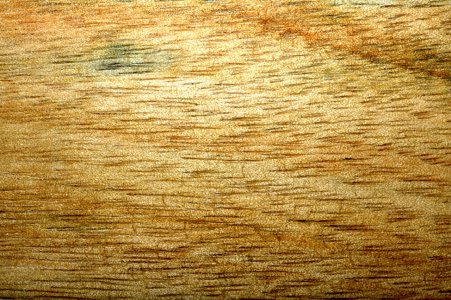

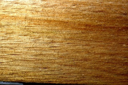

Here’s some more experience and “better” photos of sanding marks.
First the photos and the near indistinguishable scratch marks (60 grit Granat).
The only difference I notice is that those marks from the ETSC 2 is that they are a tad longer and a larger radius, which is expected.
Left is the ETSC, right is the ETSC 2:
(I had to water the surface and place a led light to reveal, further I adjusted the images so the scratches would appear better. It’s dark today with heavy rain - it’s handheld macro shots, but it shows what’s there anyway)
View attachment 376706 View attachment 376707
