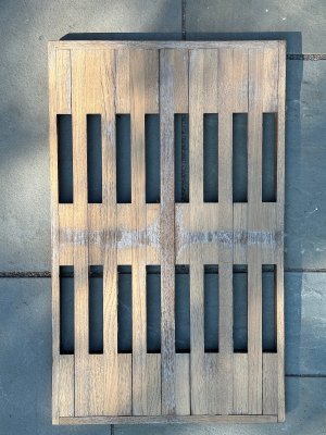

I'm thinking about picking up my ETSC 2 125 from Woodcraft tomorrow. I paid for it 3 weeks ago to avoid paying for the Trump tariffs. I have 2 teak outside door mats to sand and have been saving these for the new ETSC 2 125 sander.

My first thought is that this sander is heavy to use on vertical or overhead applications. I have a pair of teak door mats I made that need to be sanded and refinished. My plan is to compare the ETS EC 125 vs the ETSC 2 125 vs the ETSC 125 sander for this trial. I'll then throw in a bunch of 150 mm pads and see how that tweeks the outcome.
I did not find the ETSC 2 125 to be too heavy for overhead work. Maybe all day sanding would be a problem. I really like the ability to use one hand while sanding while maintaining control. My old none Festool sander required two hands to get good results. Why no one put LED lighting on a sander before is beyond me.

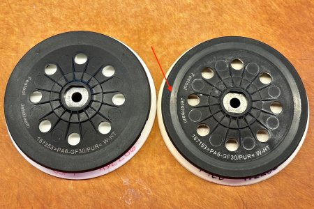

Neil, you may want to rethink the shim part. :) I have new and used 125mm pads for the ETS EC & ETSC 2 sanders. I swapped out all 4 pads between the sanders and interestingly enough, in every case, the new pads produced less drag than when I replaced them with the used pads.
Once the new pads are used for a while, the top surface of the pad is burnished by the individual brake segments along with the rubber surround that holds the brake segments in place. Here are a couple of photos that clearly show the burnished areas on the used pads. The pads shown are 492286 (soft) and 492284 (hard).
I also have a new 492288 (super soft) that I attached to each sander and the results were the same as I noted above.
Is your sander the ETSC-2 125 ? If so, the height from the screw base, to the brake pad is shorter on the ETSC2125 than that of the ETSC2 150. I tried the 125mm pad initially , and it did not want to rotate at all. I measured the distance from the pad seat area to the rim area that the brake seat against. The height difference is 1.2mm. The 125 pad from the metal seat to the seal is 3.4mm, while the 150 pad from the metal seat to the seal is 4 .6mm. The shim that I added is 1mm thick and works very well. It may well be that the 150 pad on the 125 sander, has a small gap between the pad and the break ring. From your pictures it looks like the 150 pad is rubbing against the brake ring though.
The pads are different on the paper side, with the 150mm pad having vacuum ports to the outer edge, while the 125 does not have this feature built into the pad. The pad savers do effect the outer edge dust collection. So there is more surface dust when using the pad saver adapter piece, versus the paper directly on the pad itself. The 125mm sanding pad did leave more dust on the surface compared to a the 150mm pad. This has been my experience so far. I am yet to cut a portion of the outer ring to mimic the 150mm sanding pad on the pad protection ring and see if it then works the same in collecting the surface dust.
One day Festool may bring out a 125 pad with the outer edge vacuum porting like the 150mm pad.

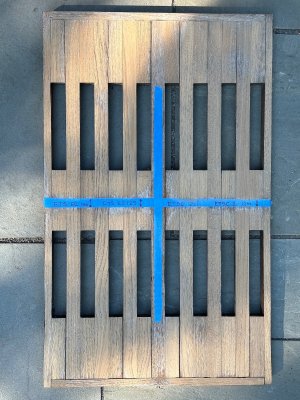

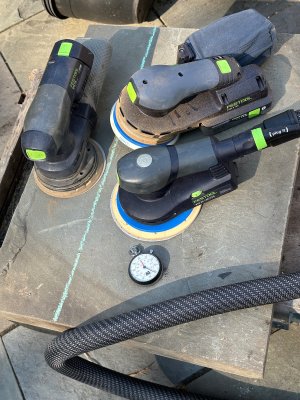

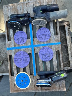

This sander comparison was just a quick way for me to see if there's a difference in sanding efficiency between the 2mm, 3mm and 3.5mm sanders.
Figuring that the ETSC would probably be the slowest of the bunch, I decided to sand with it for 60 seconds and then see how long it took the other sanders to attain the same approximate results. Nothing very scientific just a general observation test.
The 3 sanders I used were:
1. ETSC 125...2.0mm orbit cordless @ 10,000 rpm. Sanded section in 60 seconds
2. ETSC 2 125...3.5mm orbit cordless @ 10,000 rpm. Sanded section in 35 seconds
3. ETS EC 125...3.0mm orbit corded @ 10,000 rpm. Sanded section in 36 seconds
4. ETS EC 125 fitted with a 150 pad corded @ 10,000 rpm. Sanded section in 25 seconds
Here's the before and after sanding photos and the thing to look for is, are the 4 sections approximately sanded the same? If so, then the time it took to sand each section is valid.
My impressions:
A. There is a large difference between the 2mm orbit and the 3.5mm orbit.
B. There's little to no difference between the 3.0mm and the 3.5mm orbit.
C. There's a significant difference between the 125mm pad and the 150mm pad.
D. While the ETSC 2 is heavy, when sanding a horizontal surface the weight is not noticed at all and it's pleasant to use.
E. When using the cordless sanders with a bag, it's probably a good practice to vacuum out the dust port from time to time.
F. The cordless sanders continue to "dirty" themselves with sanding dust on the outside of the sander while the corded sander stays relatively dust free.

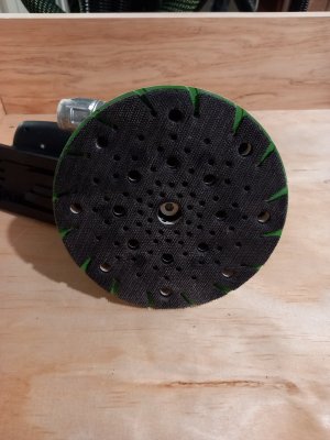

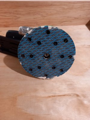

So I cut the slots in the 150mm protector pad to mimic the 150mm sanding pad outer slots. It made a huge difference to the dust collection. The sander is cleaner now and most of the dust collection is better too. I was having trouble trying to sand nicely the edge of some 18mm wide pine. I was effectively crowning the surface.

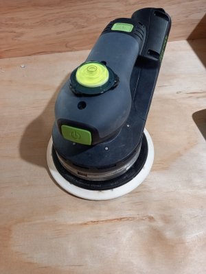

Then realised that I have a bubble level. So attached it with 3 dots of Velcro . Then took off the battery and sat the sander on the flat surface inside the box and orientated the handle how I has going to use it and set it close to the centre. 3 deg makes the bubble go outside the ring.
What I found is that the heavier the back of the sander became, ie from 4amp battery to the 5 amp battery and the sanding hose, I was actually over compensating for that weight and was tilting the sander forwards a bit, about 2 deg to 5 deg or so. A lot. So I damaged the paper going into the corner join as a result of holding it wrong. It was a good training thing for me to learn the feel of a sander when it is on the flat and not tilted an a particular way. It also helped to reduce the crowning that I was doing too. No doubt the experienced ones don't have these sort of issues that the newbies have.
The dots on the sander are from when I got it 3d scanned. Going to get printed at some stage a 90 deg holder to make edge sanding a lot easier. Take away the amateur guesswork of edge sanding a nice edge.
I am using the vacuum hose and have never used the bag. I am allergic to some woods, so prefer to have the most dust possible to be collected. So far I am very happy with. When I switch to the 125 pad, i will cut into it like the 150 pad and create the vacuum vents onto the outer edge as well.
Thanks for the reply and the very informative images and knowledge shared.
The paper I am using is 120 grit. Should have got some courser 80 grit for some of the things I was sanding. But the 120 did work very well.
Pics of the sander inside the box that I was sanding the edges of and the sides.
Sander with the damaged paper before putting on the level. (Didn't change the paper)
The sanding saver pad, with the cut out slots to match that of the original sanding pad
The sander showing the very little dust on it with the level fitted.

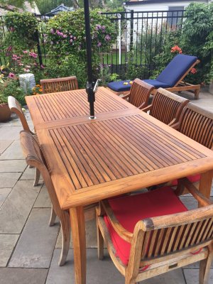

We have a large teak outdoor table that needs to be sanded every 2-3 years. I typically sand that with the ETS EC sander using both the 125mm & 150mm pads. I can turn on the sander at full speed and without a hand on the sander, I can guide it across the teak surface just by holding the vac hose at around the 2 foot mark. I think the low profile and the balance of the ETS EC allow that to happen.
I wonder about the ETSC 2 if I used a vac hose on that one?
