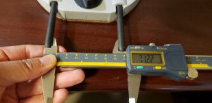

I measure 71.22mm in between the posts on my OF1400 and about 79.37mm center to center.
[attachimg=2]
If you measure across the outside of the rods I get 86.60 mm.
Minus the nominal rod diameter of 8 mm the center-to-center distance should be approximately 78.60 mm.

And on the other side?
If you measure with them sticking out that far, you might get a somewhat false measurement, especially since one of the rods is only clamped in one spot.
