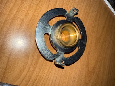

Is the adapter in the foreground of the above picture the adapter for Porter Cable type guides? I haven't used the 1400 for template routing but plan to. Just wanted to make sure that the adapter shown was to mount PC guides to be sure didn't need to buy one.
If you're meaning the template guide rings that screw into each other, no. That's a standard 30mm template guide or copying ring (flange underneath).

Actually, what you describe is what I have. I tried my PC guides with the threaded collar and they fit. Possibly I bought that separately when I bought the router. I just haven't used it.

The scope of delivery is different in North America. The PC bushing adaptor is supplied as standard here, whereas the 30mm unit is standard in Europe (and probably the rest of the world)
I would add a bit of a caution for @grbmds ....Be aware of the possibility that the collet nut can make contact with the inside of the PC type bushings. This depends a little on the brand of bushing. The "specific dimensions" are about the OD and thread/nut, not the ID. Some brands are smaller inside and a deep plunge can make contact. This will loosen the bushing, as it spins out of the nut. It doesn't happen with all bushings, but look out for it.

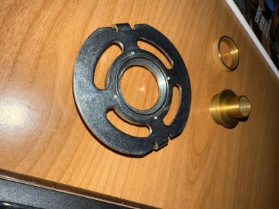

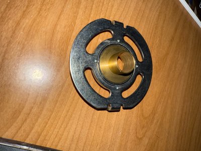

@Crazyraceguy So, now you have confused me. The attached pictures are what I have and have had since I bought the OF1400 (either came with or I bought separately - too long ago). I have an interest in making some table saw jigs for Microjig's Matchfit fixtures. They have a template which fits on the bottom of, they say, almost every router, which will locate the router cuts. However, the router must be able to use PC guide bushings. I have used the guides bushings once (I remembered last night) with no problems at all. Microjig will not really verify whether theit Grid Router Guide will fit on the OF1400 but indicates that, with the correct guide adapter it will. This leads to me trying to verify that the adapter in the pictures attached is the adapter Festool sells to use PC type guides. It seems obvious to me that it is what I need, but what seems obvious is sometimes not the correct answer. In case it matters I live in Illinois and bought the router from a Woodcraft in Wiscconsin so it is whatever the North American version of the router is.

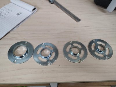

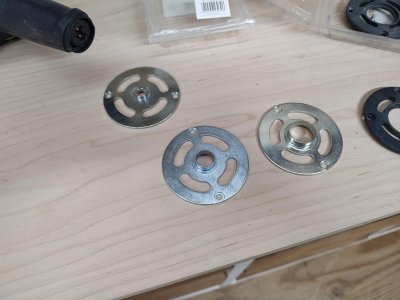

Hopefully, this doesn't make it worse, but the pics below are the stamped style copy rings. These are the ones for an OF1010, so the mounting is different, but otherwise similar.

In NA the F1010 comes with a PC adaptor too. Do you get a smaller copy ring instead?

After initially not seeming to have an anwer, Microjig was able to provide a direct yes answer to my question about the accessory I asked about in this post. I appreciate the informational answers on the FOG which addressed my question. However, like most posts, the responses quickly began to provide information that wasn't beyond the scope of my question.
I tried the guide adapter for PC guide bushings awhile ago when making too many trays/drawers with a Leigh dovetail jig. You can insert the adapter in two positions (2 tabs so you can rotate it 180º and insert it again). I tried mine both ways. One way was not centered. A centering mandril definitely showed an error I wouldn't want. Rotated the adapter 180º and it was perfect. I put a dot of whiteout on one adapter tab and a dot on the corresponding mount point so I could easily repeat it.
What led me down trying this was noticing that the base has screws you could use to adjust its position. Likely this is done in the factory as I don't recall ever seeing instructions on calibrating it. So that meant one way it installed was likely gold. YMMV, but give it a try. If you don't have the centering mandril, put a 1/2" ID bushing into the guide base and a 1/2" spiral in the router. If it drops through, you're good.
