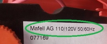

So does any other logical fallacy - but we’re dealing with facts here supplied by you arent we.  And since you won’t let the saw speak for itself, instead using others videos, we’ll have to confine ‘trouble-shooting the problem’ with you.
No need to re-read your posts, once is enough, though you might want to take your own advice and note the question marks I use.
On a side note, since it takes the same effort to post an image either way why provide the wrong thing?  Here’s a pic of mine below showing the label location. Just blur any serial numbers if you need. Thanks.
