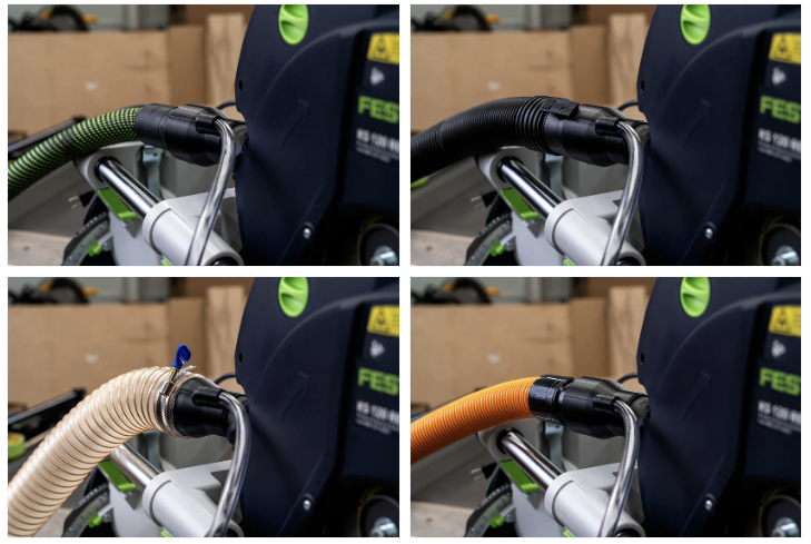

I bought the zero clearance throat plate kit kit from Inspire Woodcraft -- the verdict is still out on how well it works -- that includes an adapter for attaching a D27, D36, or 2.5" shop vac hose.
Even with the added cost of the kit ($53) you can get a short run of hose from the big box store ($33) and still come in way under the price you'd pay for a green hose.
I should note that I plugged the shop vac hose into a Fein Turbo 1. To get a snug fit on my CT MIDI, I needed to wrap the end with some blue tape.
