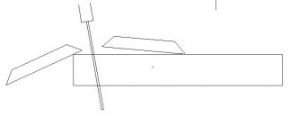

I have been thinking about the beveling discussion a lot.  I think you could screw a piece of acrylic or wood or Uhmw or something to the wing, giving you the same support.  I know it would be an extra step, tedious and maybe it would not work but the wings do have holes and it would be simple enough to cut a rectangular piece about the same dimension as the saw, screw it in, cut a kerf at the angle and make the cut.  Not saying this is the way to go, but a thought.
Scot
Do you mean something like this? Lol sorry for the bad rendering..
Yes...exactly what I was thinking.

I would be inclined to add a wedge to one of the flat bases and leave it in place. That way it could be just attached like any of the accessory bases.
Seth
I think this is the best way to go as long as you don't loose too much depth of cut. The stick fix base would probably be great for this. In the two years the carvex has been out in Europe and I think in Australia, this issue must have encountered and dealt with.
I'm guessing not  more than an 1/8" of cutting depth would be lost. It won't take much for a back bevel.

It appears as if the base is 3" wide (could someone post the base width please) a shim at the edge of the base 1/4" tall yields a 5° (rounded, 4.76° actual) pitch. Seth is correct, depth lose is 1/8".

I had mentioned this in another thread and it's pretty much what elimelech12 drew in his sketch. Remove the plastic runner(s) from the angle base and attach an 1/8" piece of material (Plexi, whatever) in its place. Here's what it might look like.
Just another thought, but a 5 degree shim would also work with some hook and loop for the StickFix base [wink]

Looking at Shane's post with the base mockup, why can't you just make the cut without the add on base piece? If you removed the add on piece from the saw in the photo couldn't you just run the saw on the wing? What am I missing?
Maybe that's why this has not come up before, the rest of the world just makes the cuts as needed.

He's just showing how the plate would look, but that's for a cut that would be going in the opposite direction essentially making a back bevel
Here's what the Tool Snob guy faced.
and as you cut further into the work piece it may ride up like this.
[attachimg=2]
and it may hang in transition.
But this particular problem will be overcome in short order with some sort of wedge attached to the standard base.  It's no big deal.
I think the bigger question is how well does this unconventional bevel base work in the middle of flat material for more routine bevel cuts.  Is it stable?  Is half a foot enough for reliably stable cutting from above and below.

Tom's post #57 is addressing this directly, instead of the angle plate being being adjusted concave, make it convex and support from the other side.
EDIT: unfortunately that won't work though if there isn't enough material to support that side of the plate, as in scribing a cabinet

Nice drawing. In this case decrease the acute angle from 5º to 2º. The points of contact are now the edge on the right wing and somewhere in the field of the left wing. You would still get your 5º back bevel.
I'm not sure I have enough time in my life to replace my TS with a[ny] jig saw. There are just some cuts that are not jigsaw worthy.
If you're back beveling a cabinet scribe, how often is the base plate of a jig saw completely supported on the face frame/filler? Even on a 3" filler you're not getting the entire base plate supported. I can't recall a single time when I scribed a piece and the saw base was fully supported.
