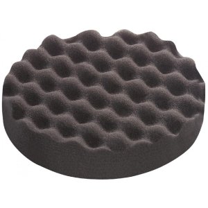

5. After sanding with 4000/5000 I then use a liquid polish with a black or white foam sponge. The RO 90 and all Rotex sanders for that matter, need to have a polishing pad attached when using the foam polishing sponges. All Festool Rotex polishing pads are color coded green.

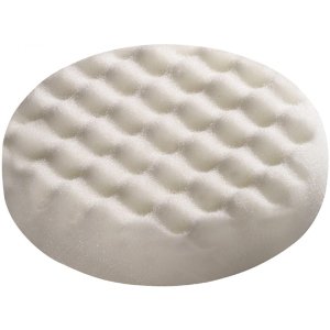

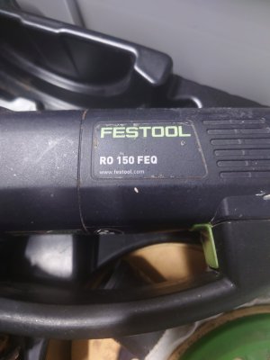

Apologies .... bit of a post overload today. But to confirm, this is the Rotex I've been mentioning previously.
I mention as I'm not too familiar with the suffix data .... the FEQ reference. It's just to check I'm refering to the right machine for the job before I destroy something valuable :)
The unit is off to Festool as we speak for a shake down so will gone a couple of weeks minimum I guess ..... this is the unit, it's a Rotex 150 FEQ .... hopefully the right one for the job.
It'll be interesting as to how it performs after the Festool service...maybe the heat issue will be minimized. :) I owned one of the original Fein multitools that had an aluminum head and after using if continuously for about 10-15 minutes I'd have to put on heavy leather gloves to continue the work. It didn't burn your hands but it was very uncomfortable...just part of its heritage I think.

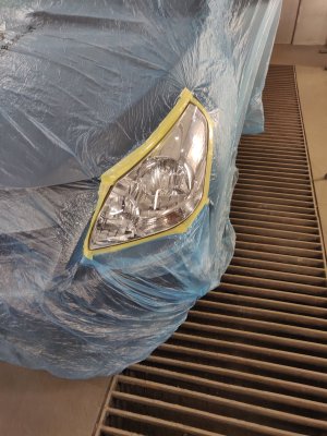

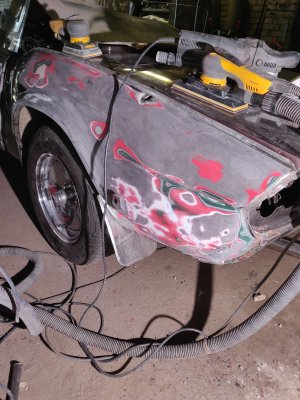

Thats the ripper right there. You are unstoppable with that, on anything. Mine have some nasty resonance (from time to time) from somekind of washer under the pad, maybe i should ship it in. Bought it in March
Remove dust port or not, use Festool own polishing system or Koch or whatever, you can make serious corrections with that. Get a pair of ear muffs and frontal handle.
I grinded off eem, i think seven different coats of paint with it today. From Triumph Spitfire. Used bit of RO 90 and Rupes long block and two Deoses also. We are working with what we have there on panel because budget does not favor full strip down. Sorry that theres only pictures of other tools, Festos were hanging on my cart, behind me. :)

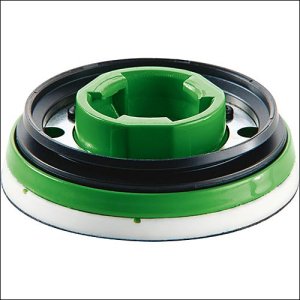

Regarding lights. RO 90, soft pad or interface and let it rip in rotex mode on the haze. P500. Do it once in fine mode also. Then get 800 and get the previous marks out. If you want to be pedantic, continue with finer grits (i did it on this Toyota). Mask it and shoot 1.5 to 2 coats of 2K acrylic clear. Later in life theres enought to buff when the need arises.
Paintbooth isnt a must.

First orbital polisher that i have used is FLEX PXE 80 wich i aquired in spring. Other than that, every workshop where i worked had only rotaries.
So, i got RO90 for bit more oomph and different role than Flex. Dedicated polishers would be nice but come on, Mille is a thing. A good one but... monofunctional.
