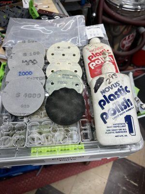

Here's my RO 90 package for polishing headlights:
320 Granat wet
400 Granat wet
500 Platin wet
800 Granat wet
1000 Platin wet
2000 Platin wet
4000 Platin wet
Black waffle pad
Novus Red
Black waffle pad
Novus blue

The link redirects me so I can't see it, is there some kind of sealer supplied, as I found after polishing them they didn't last real long before the UV got to them again?
Got the Sedge headlight polishing kit "blue" (it includes a finer polish in addition to the base "orange" kit). Thanks for putting that together, @Chip S. Have not tried it yet: we're still over 110º/43º and worse out in the sun
I am curious to know how well this kit works for you. I used my RO90 to polish the plastic hood of a John Deere Riding Mower that was sun faded. I wet sanded first with 12 different grits and then began to polish. I was unable to get the plastic to shine completely. I ended up buying a Griots Garage orbital that has a much longer throw compared to the festool. Much to my surprise, that did the trick. I need to do the headlights on my car and the orbital I bought from griots is a 6", too large for the headlights. Good luck.
That's the thing that a lot of people overlook. There is a coating on them originally. Once that fails, the polishing starts. It takes a bit more work the first time, because some of it is still there. After that, you either have to seal it in some way, or get used to the idea of doing it every other year or so.

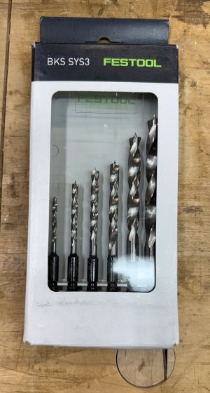

I wanted to get some metric Centrotec drills, would have preferred the style with replaceable bits, but they don't seem to make these with brad point bits. Found Festool 577396 Drill bit case BKS SYS3 D3-10 CEW on Amazon.
