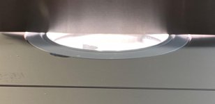

Curious if anyone has had any issues with the table insert as it is proud of the table by .012"-.024"?
[attachimg=4]

Thanks for the info...I measured .012" on one side of the insert and .024" on the other side. I'll check mine again because the differences in height are a concern. If it's proud of the base plate, it should be the same dimension all around the insert.
I just realised, it could be the ring on the base plate of your router pinching the insert ring from behind. You could have accidentally moved the router when fastening it to the table. At least what I noticed is that the routers inner ring on the base just center over the protruding part of the insert ring.. and the protrusion is not that high..
