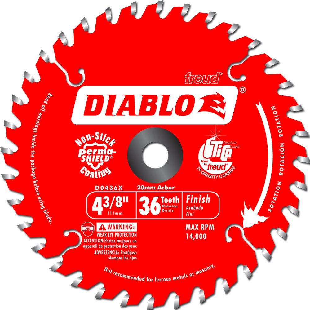

When doing pocket cuts in sheet goods I like to finish the corners with a cordless jigsaw so I want matching kerfs and I want the uncut portion to be as short as possible. I get both with this small diameter narrow kerf blade.
Despite the size of the picture, it only fits the 55 saws.
