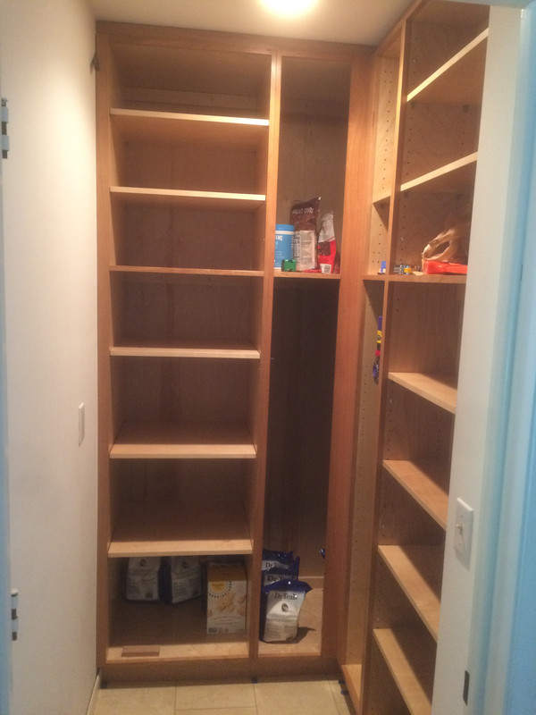

Can you comment on "extending the line" to make a long row of holes? Basically I'm wondering if I have a really tall cabinet, and start the row by referencing the bottom of the panel, front and back, for example -- do the front and back rows of holes line up nicely in the end? If the jig has to be moved to do a long row?
I don't need absolute perfection, but even 0.5mm difference can cause shelves to rock. I'm just a hobbyist but recently built a large pantry unit that did need long rows of holes for adjustable shelving, and before I spend minimum $120 on a jig I want to make sure it can handle long rows with good accuracy.
In the above example the WP jig would have to be repositioned many times.
