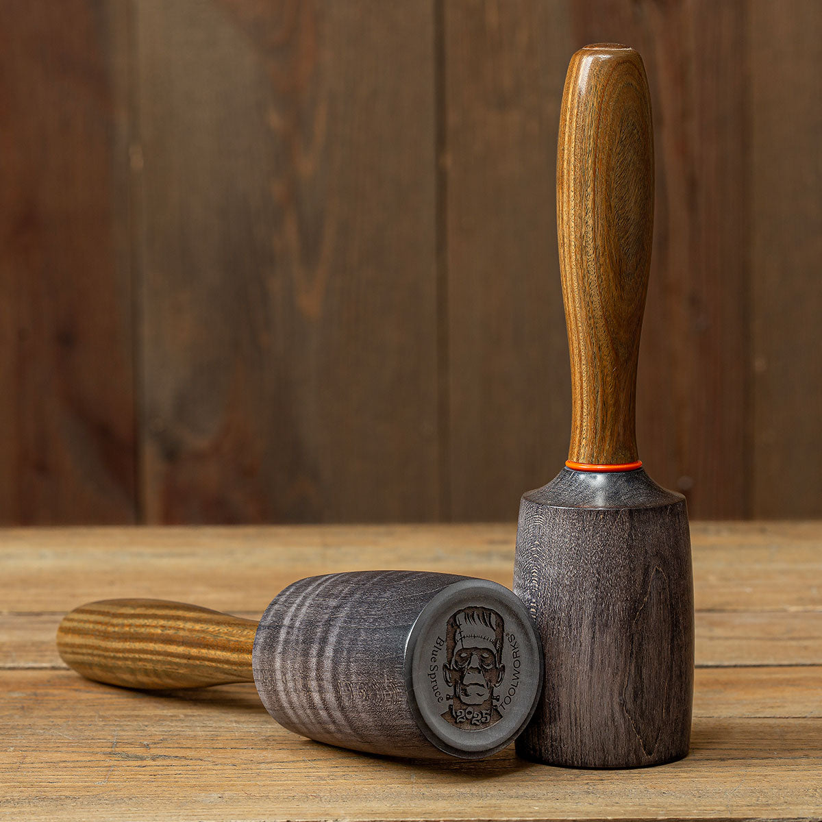

Earlier in the thread, I mentioned that Deneb from Lie-Nielsen showed me that resin-impregnated mallet that felt really nice in the hand. I figured it was in their catalog but haven't seen it anywhere on their website and messages on Instagram have been left unanswered. But, I happened to be looking at Blue Spruce's website and I think that might be the one Deneb showed me. It looks exactly like the one I handled. And they've got a Halloween Frankenstein special that I think looks pretty dope. Dope enough that I might order one.
But I'm planning on visiting Lie-Nielsen next week, so I'll confirm it then.

I've had the Blue Spruce round mallet for a long time. I love it for chisel work, but I'm also not the guy to ask for opinions on chisel work :) It can have glancing blows so I did pick up a regular flat-faced mallet from Blue Spruce. I still grab the round one, for whatever reason.
I'll add that I've used the round mallet a lot for chisels, assembly, "this needs convincing", etc and there are no marks on it at all. David's resin process definitely works well.

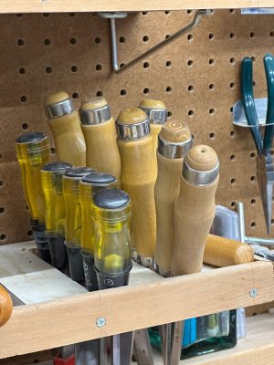

This has been my chisel solution for years, the Stanley chisels which were the first set I purchased, are made in the US and have steel caps. They're used for all sorts of rough construction tasks and have been routinely hammered on with an Estwing claw hammer. If they needed to be sharpened in the field, a RA grinder with 120 grit came to the rescue.
The Pfeil are Swiss made and only used on the bench by hand or with a light tap of a mallet. They are only sharpened on proper bench stones with a proper guide.

Since we had some discussion on mallets here, specifically the Blue Spruce, I've been thinking about them a little since. How difficult is it to replicate the resin impregnation of a wood mallet?
I'm thinking about a rectangular mallet head made from white oak, and I remembered there's a vac chamber sitting in a pile in the garage - if I get a vacuum pump (like the Pittsburgh or even Icon from Harbor Freight), could I impregnate the white oak? I've never worked with epoxy before (I'm presuming it would be epoxy), so is it a matter of putting the mallet head in a smaller container, filling it with epoxy, putting it in the chamber, sucking the vacuum and waiting three days? Does the epoxy solidify around the mallet?
