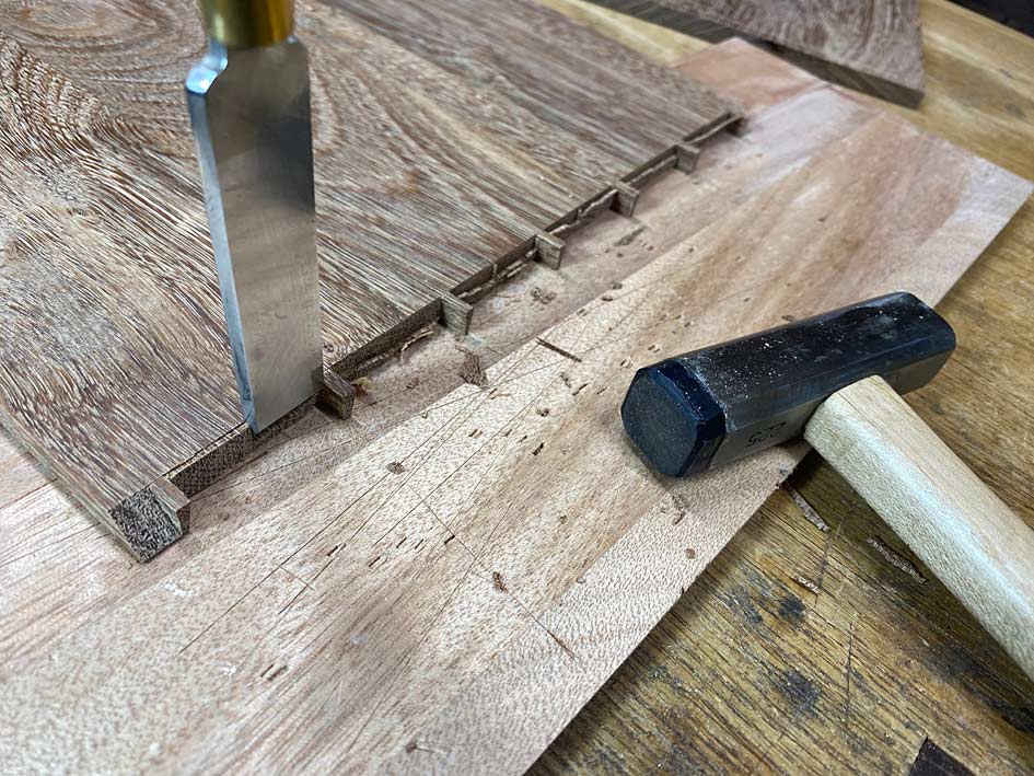

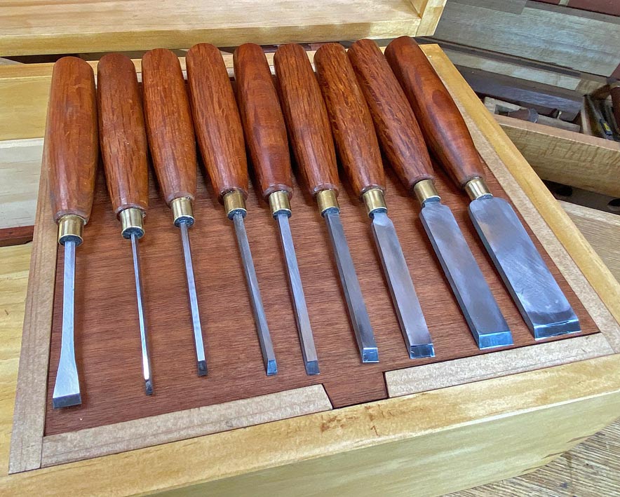

Yes. And a close look at the Garrett Wade offerings clearly shows the wood handle proud of the ring. As long as you strike the handle square-on, there should be no damage to the mallet.The chisels in the photo do not appear to have been set up. By this I refer to the reinforcing hoops being positioned further down the handle, and the exposed ends folded over the steel hoops. If you do this, it should not damage a wooden mallet. In any event, oire nomi (Japanese bench chisels) are designed to be struck with a gennou (steel hammer). This adds to their precision.
Here is my set of Kiyohisa ...
... and Koyamaichi ....
Examine the handle ends. You will see wood and not steel.
