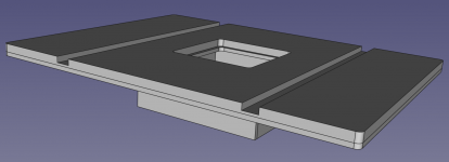

I noticed a couple of people posted their custom-built drill press table, so I thought to add another one. Who knows? It might  inspire someone to make an even better one.
I started out with a CAD drawing. If anyone wants a copy, it is available, but in a non-standard format (FreeCAD).
First I have to move the handles outward, because otherwise they would get blocked by the platform.
I also added a Wixey depth gauge and a laser, because my drill press didn't have those.
Here's the platform with integrated T-tracks and centre scales.
