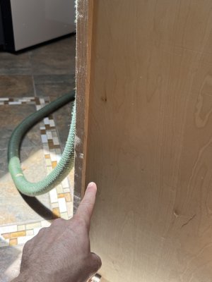

Any advice on how to make this cut?
bwehman
Mar 21, 2016
353

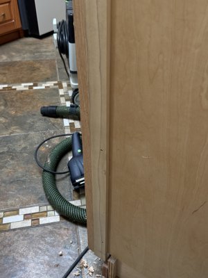

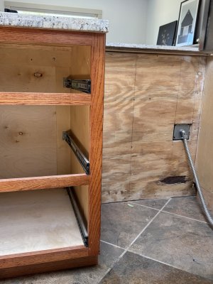

Hey all! At a client's and in a bind. I'm fitting a new oven and the past cabinet installer didn't do a great job with final fit. The face frame is wavy and needs to be trimmed back to the sharpie line. I have all the Festool system available. Any ideas? My first thought is clamp a rail, TS55 as much as I can, and block plane the rest but that seems clunky.

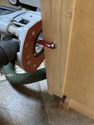

Agreed on the TS plan. I think what I might do is make a piece of wood and attach to the backside of the face frame. I'll make the strip as thick as I need to basically ride a flush cut bit against, and then use the 1010 or MFK to get the lion's share. From there I'll use the Vecturo and reference a blade against that same strip for the rest. Wish me luck!
I'm with ChuckM wrt using a router. If you don't have double-sided tape Supergluing the guide stick to blue painters tape works just as well. If I was in a hurry I might look to flush trim the face frame all the way back to the cabinet side. Super fast setup and it could give you a little more breathing room. Finish the couple of inches at the top with a sharp chisel.
Palm router with a flush trim/pattern bearing bit and a straight edge clamped (or double-face taped) to the face frame. The rest with an oscillating multi tool against the straight edge.
+1 for this being the easiest and simplest way to fix it.
Welp, this worked perfectly. The only part I couldn't get to was the last inch at the top near the counter, but was able to knock that out with a block plane. Thanks for processing this with me everyone!
