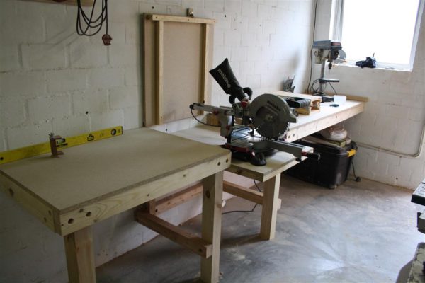

I rather like this setup.  The saw folds away and a plank replaces it.
https://woodworkjunkie.com/diy-folding-miter-saw-table-make-the-most-of-a-small-shop
