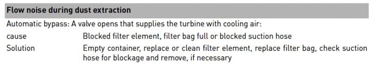

I question the term "automatic air bypass system".  My experience from servicing commercial grade vacuums at several self service car washes, and the most rudimentary understanding of universal motors in general is that there is no such thing as an activating bypass in common vacs.  Bypass cooling simply refers to a small cooling fan on top of the motor attached to the armature.  It does not activate when airflow through the vac is somehow blocked. Because it is attached to the armature it runs continuously, cooling the motor at all times.  The air intake/exhaust for this small fan is separate from the suction for the vac.
Pretty much every cheap shop vac and small power tool you own has one of these cooling fans-so to promote this feature as something special is a bit of a gimmick.

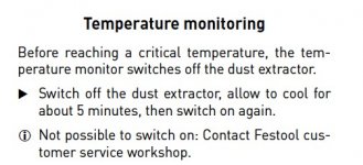

Brice,  here is what is written.  Consider it what you will.
And if you are concerned about the safety of the unit and over heating, here is what is in the manual:
[attachimg=2]
