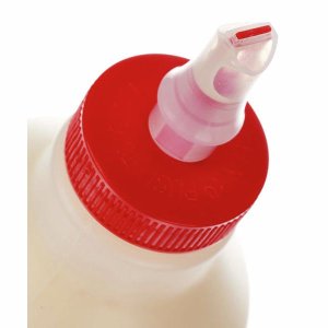

Sneaking in here to derail the glue discussion and add my glue bottle experience. Like others, I'm not overly fond of the Titebond caps. Great when they're clean; terrible when they clog. I tried the Gluebot and while it works great for application, the fiddly gasket is, well, fiddly. I switched to the Milescraft 5222 Glue Mate and those are fantastic. No gasket, just a wedge seal. Tighten until you can't hear any air escaping when you squeeze the bottle and you're good to go.
I always considered cleaning the glue caps as just the cost of doing business.
The most useful tool for cleaning Titebond caps is a pair of pliers.
1. If the glue is dry, use the pliers to gently squeeze the cap so that the opening “smiles”. That will break the hard glue free from the cap. Use the tip of the plies to tear any of the glue away. That is what I encounter most often.
2. If the glue has not been used for while and the cap is completely clogged, then I use the pliers to pull the outer sliding piece entirely off the cap. At that point I find a piece of wood (usually I break up a tongue depressor for that) to poke out any partially dried glue. Hardened glue gets broken up by a squeeze of the pliers.
This is the best image of the cap I could find. The clear part is the part I generally squeeze into a “smiles”. It is also the part I yank off and clear out with a stick. The screw cap rarely has issue. There is a horizontal hole in the “tongue” that pokes out of the clear part, and that sometimes gets clogged too. Yanking off the clear part is the only way to access that.
When the caps are new, they rarely clog. For that reason, I don’t buy large jugs of glue and pour down into the bottles.

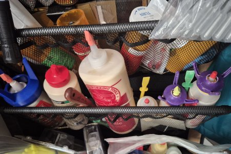

I have posted previously that I am a Glu-Bot fan. I know some don't like them, but personally I can't imagine a better glue bottle.
Seth
I like them too, especially for dowels, Dominos, edges, etc. but they don't do "volume" very well. That's why I keep the condiment bottle type too, with the tips cut to different sizes. Gravity works far better than constantly squeezing/re-squeezing a Glubot.
The gasket issue can be overcome with the same cutting board wax/oil blend.
Buy in bulk and then use condiment squeeze bottles. You can buy 6 on amazon for $17 bucks. So you can keep plenty around the shop.
