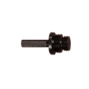

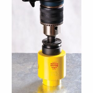

Starrett also makes what they refer to as an "Oops arbor". It allows you to mount a larger hole saw to an arbor and increase the diameter of the existing hole while using the original hole saw as a guide.
