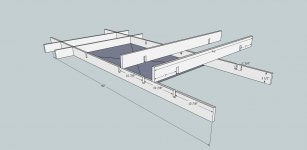

I have been wanting to make a panel cutting helper for a while to fit my existing tools and which is easy to move around, as I dont at present have a workshop. Something that will work with my sawhorses and MFT3. So here it is... 1x4's with slip dados (or whatever they might be called). It is a very tight fit on the MFT and a tap with a rubber mallet is needed. If I want to install it on the saw horses, I slide the inside cross members to the inside slots. A 1" piece of foam makes for a nice surface. Total cost, $15 with a couple of hours thrown in to cut the slots. Surprisingly, the thing works pretty well.
Here is a pic of the gizmo installed on the MFT, and a drawing with dimensions. Now if I could only figure out something that I can lay the panels on to swing them on the cutting surface.
